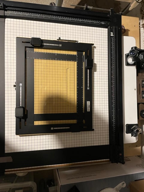

So assuming my subject line is not clear, time to time I have difficulty to make sure my horizon line is really horizontal and building are vertical. So what do you do to make sure the lines are correct? How do I make sure my easel is correctly aligned with those lines?
Cheers, Fatih

I crank the upper blade down to the horizon and adjust the easel. The put the blade back to its original position.

i fitted my easel with thin tape in a tic tac toe formation, then i use wooden planks to move my easel from there.

I too use the easel blades for horizontal and vertical alignment when needed.

All of the above are good.
And, your eye is really good at assessing this as well. If a test print looks skewed, then correct. Usually you'll have a couple of chances to get it right before arriving at the right exposure, contrast and manipulation scheme anyway.

Draftsman's triangle, position against the masking blade to the side. I keep one hanging on the wall in the darkroom.
But I find my eye's are plenty good enough when making prints. I do, however, have trouble keeping the horizon horizontal when taking slides so my cameras are equiped with gridded screens (Nikon E-Screens).

Draw a grid on the easel and line up the negative without paper in the easel first.

Thank you all. Easel blades were my plan to use but then graph paper idea came. I was searching for an adhesive option and then found transfer paper on Amazon, bought a roll and tried. The result is not too bad. 😀
