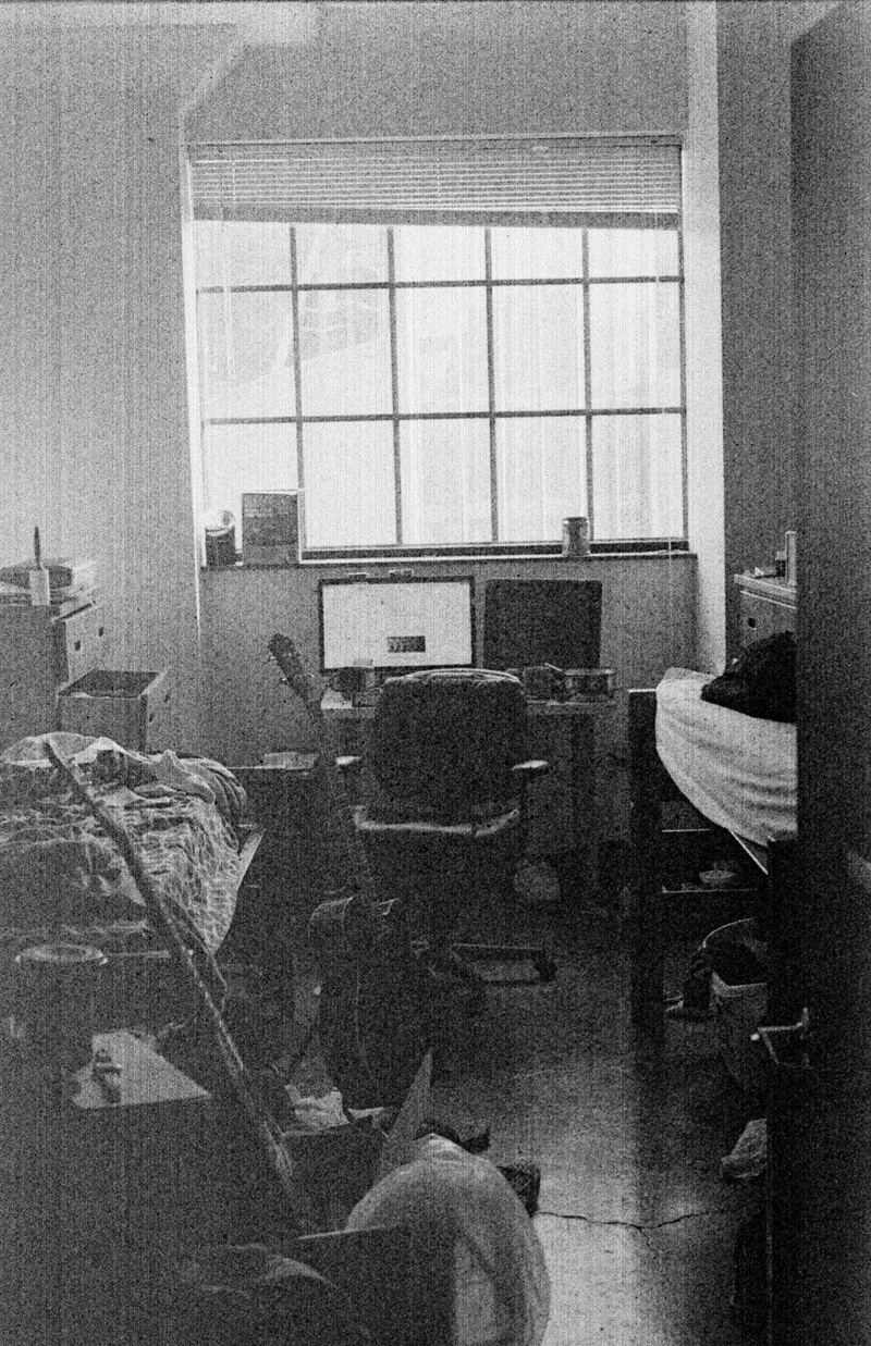

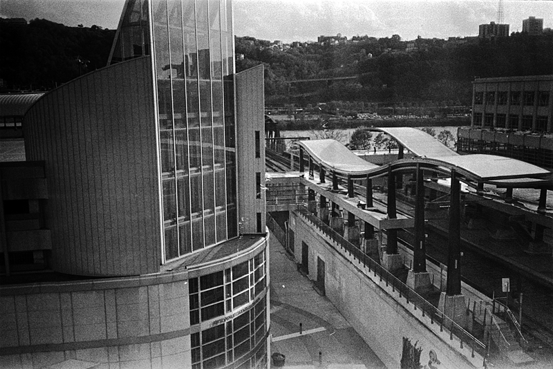

I've attached two images. The one of the room is Caffenol-C @ 20min. The monkey is Caffenol @ 30min.
The Caffenol-C negatives came out looking dark. I couldnt put my up to them and see through them like tinted glass. However, when put up to extreme light I could see tons of highlights. They scanned like crap though. There wasn't enough range and I think the scanner had to blast too much light.
The Caffenol negatives came out with being able to clearly see through them. The highlights werent black enough so I know I must simply adjust my development time.
I'm wondering why the Caffenol-C behaves so much differently. The negs dont seem to be underdevloped, but they don't seem to overdeveloped. Yet I can't see the images at all with my naked eye like I can with regular negs.

Caffenol Negs - see images with eye, see through, tinted
Caffenol C Negs - only see images with backlight, not tinted, not much range

The development looks pretty uneven on both of them, which makes it that much harder to judge what's going on. 20 minutes is a long time for Caffenol C, assuming we're using the same recipe (mine is 8 rounded tsp coffee, 5 tsp washing soda, 1/2 tsp ascorbic acid, to make 16 ounces)---I use 12 as a starting point.
Is there general fog on either roll? I occasionally get a pretty foggy roll out of Caffenol C, which makes it harder to judge the negatives by eye, but it usually seems to be OK for printing/scanning through.

There's no fog on the C negs. Only on the Caffenol negs but that's expected.
I read one guy got the same result from C and said he fixed it by fixing the negs longer.

It's confusing how the negs are so black but under intense light the images can be seen. As you can see, my scanner has a hard time scanning them.

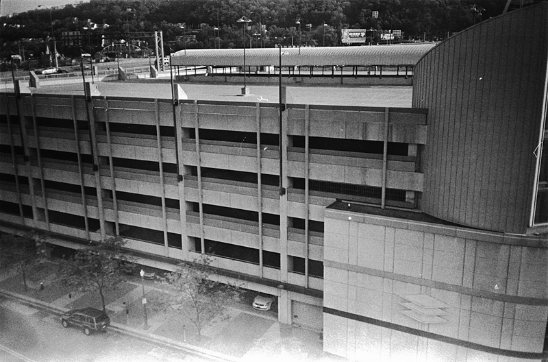

Thanks for everything guys! I think the problem with the film I did in Caffenol C is that it's 400 speed. If I had a better scanner I could get the images out a bit better. Like you said, low speed films work a lot better.
I just developed another roll in my Caffenol though and it came out great. I just added 5 more min to my dev time and rinsed longer. This was Caffenol not Caffenol C.
