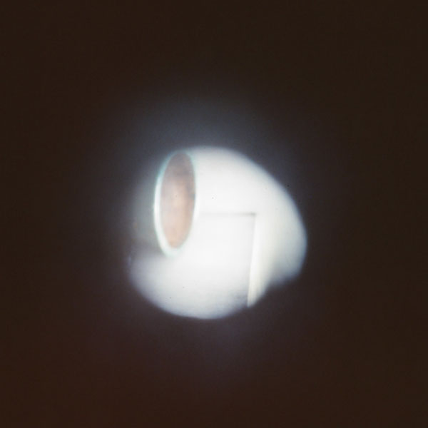

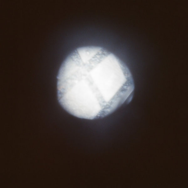

Could anyone please tell me whats wrong with my pinhole camera?
It seems that I cannot expose for the full image.

Post some photos of your camera and some details. Is this a new camera you made, never used before, just became a troubled camera after years of service?
On thought is the hole is not right, miss shapped but I thing more clues are needed.

I just started using an Ilford Titan and love it. So far the results have been great. I'm not up on the math relating to the relation of the size of the hole and the distance to the film plane but that information is available. From the examples it also looks like the pinhole might not have sharp edges.

Yes, more details are needed. Dimensions such as pinhole to film distance and film size, etc. Is the pinhole in paper-thin material? I've never tried a pinhole in a thick sheet, but those look like what I might expect if I drilled a small hole through a thick piece of stock.
It is surprising how easily vignetting can occur, especially if the camera is set up for a wide angle of view.

Thank you all for your help. I shall post more images of the camera tml.
Yes it is hand made. I have a small piece of wood (5mm thick, laser cut a hole), and a foil with a pinhole right behind the wood.
As far as i can tell, the hole in the wood piece and the foil is the same size.

There's your problem. It isn't a pinhole, it's a smallbore tunnel.
Cut a hole the size of a quarter, put the foil pinhole behind - or in front - of that.

I agree with E. van Hoegh. (It looks like my original guess was on the right track.)
The ideal pinhole is a perfectly round hole in an infinitesimally thin opaque sheet; e.g., a knife edge around the hole. All the supporting structure needs to be totally out of the light path.
I have more than you may want to see on line of the 4x5 'box camera' I made last year. The holes the pinhole plate mounts against were at least 3/8 of an inch in diameter. In addition, the surfaces away from the pinhole plate were counter bored at about 7/8 inch diameter to about half the thickness of the 1/4 inch plywood pieces. That camera uses a dimple-and-sand pinhole in 0.001 inch brass shim stock (and may be the best I've made so far).
