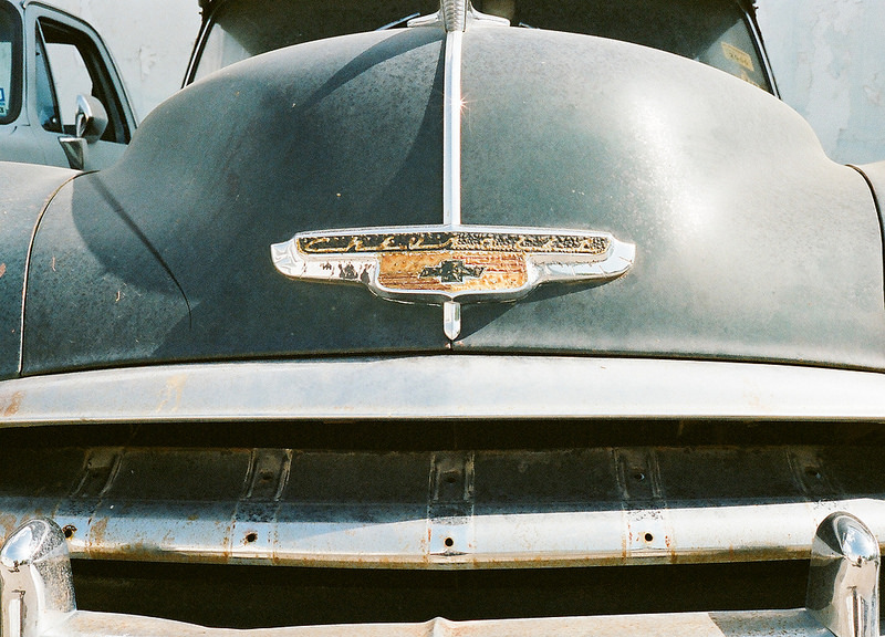

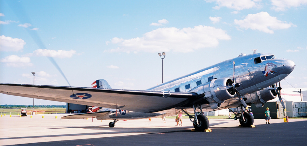

I love this little camera but I notice a black weird swirl line in the photos that I get back. I thought it was perhaps the photo shop where I get the film developed but then tried another place and got the same results with the swirl in the same location.
See the swirl line going up near the wing?
attachment.php
Same sort of swirl line on the left portion of the hood.
attachment.php

Any in portrait orientation? Looks like something in between the film plane and back of the lens (inside that little chamber).

Open back, use bulb setting to open aperture, set at f1.7, hold up to light. I bet there is some foreign object in there. hair? film shard?

I would agree.. Looks like a hair stuck in there. Great camera. Cool pics.

Looks like a hair in the film chamber, take a close look in there and you will find it.

clean the hair out of the camera
Lol, maybe the hair came from my arms. I'll check it out. Thanks guys.

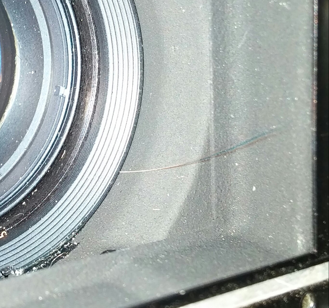

Found the issue! Damn cat hair!
