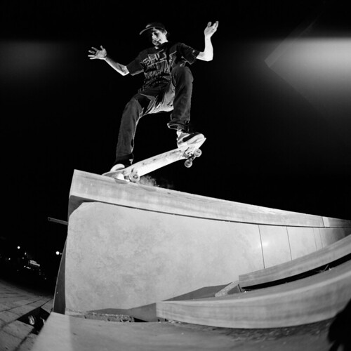

I've search a little for a topic like this and couldn't find anything. I'm sure it's a common problem but at the same time I don't know what it is. I've got one bronica back for colour and one for b+w. The one which I shoot b+w in keeps giving these weird flares, sometimes entire gray bars through the frame. Is this a light leak or a winding problem? I've posted a photo as an example of what's happening:
Thanks for any help

Yes, it is indeed a light leak - If you look at the foam around the top of the back where the door meets the locking mechanism, you may well find it gummy or ripped up. There are other thin strips of foam around the opening that may have also turned to mush.
I managed to find some from an ebay seller by the name of interslice - Give him a call, and I'm sure he can send you a pack of foam for peanuts.

A while back I placed some shots of the offending areas of an SQ series back near the bottom of this page. That might help if you decide to fix it yourself. In the light leak example on that page, the seal along the opening edge was almost completely missing. Yours is apparently just beginning to go. The problem seals are a foam that reverts to gunk.

Those might actually be down to flash flare from the Bronica fisheye - it suffers from it really bad when you get the flashes too close to the edge of the frame and is very common. It ruined at least a third of my shots when I used to use it for skate shots with off camera lighting. Did you crop the edge of the frame slightly? The reason that I don't think they're light leaks:
- You were obviously shooting in dark conditions, do you get this on all your exposures in the same place, especially in lighter conditions?
- Light leaks tend to either be sharp streaks, or follow difraction patterns, this doesn't look too much like that. It just looks like the typical Bronica fisheye flare, do you see this in shots taken without the fisheye?
If you don't already have one, I would suggest investing in a polaroid back when shooting with the fisheye and off camera lighting, it's very useful for checking the flashes aren't too close.

It very well could be flash flare but I get it on all of my other shots from this back. Sometimes it's full bars through the frame, sometimes it's just those pointy ones.

The "mirroring" effect is definitely the light leak...and it is as Dave mentions the seal where the back meets at the top that is the culprit. The light leaks on to the film frame BEFORE it wound on to be exposed. hence sometimes if you are shooting quickly some appear to be free of a light leak. That is because you wound the film on quickly before the preceeding frame has a chance to be fogged. If the film has not been wound on for a while, then the next frame has a high light leakage. That is why the leak can sometimes be absent or appear differently from frame to frame. K
This is an important note, probably in diagnosing any light leak. The film travels around a bit before and after the spot where it is exposed. The scan of a badly zapped negative ("Oh my back!") on my gallery page represents what eleven of the twelve frames looked like, to a varying degree. The first frame, taken at that same outdoor location, was fine and printable. I loaded that camera in a relatively low light level indoors at home and had wound it to have frame 1 ready to go, so it got to the masked exposure area unscathed.
One also needs to think about the image being inverted on the film when trying to work backwards from the light-struck spot to the camera body leak.
I imagine buying and using old cameras will help all of us improve our diagnostic skills! :tongue:

I've decided that I'm going to keep using this back until the foam gets here, I'm just going to tape the back like crazy with black electrical tape. Has anyone ever tried this out before? It's going to be janky, I don't doubt that for a second, I just hope it works.

Yes, I have done it and it works. You only really need to tape the top since that is the most likely location for the leak. That means you only need to remove that to unload/load. I also still tape them up on very bright days and serious work (commercial) since I can not afford a failure. Kal
