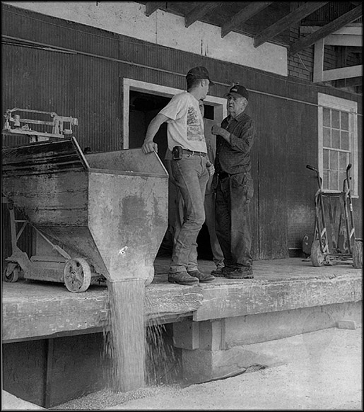

I thought it was something I could wash off the negative, but it's not. It looks like a stain, maybe? Does it look to you like something I can fix? I'm sure you see it, but it's in the bottom right corner.
Thanks.
Janet

Really looks like a water mark, particularly if your film was dried while oriented this way. How long did you let it wash for the second time around?

That's what I thought too, till I looked at the negative. It doesn't have that chalky look of residue from water. I use Hypo and then rinse 7 or 8 minutes. It sort of looks like a stain, but I'd love to find out it's a water mark. It could be fixed then, yes?

The spot is darker in the print, and therefore lighter in the negative.
I think this is some other problem. It also looks like it continues out of the picture area. Please look outside that frame in the OP and in the adjacent negative area. If it is there, it is a development problem. Possibly water hit the film before starting processing, or a drop of stop bath.

Nice catch PE the spot has less density on the neg not more like you would expect from a waterspot.
That said I would still try a rewash---don't have anything to lose

I agree. It cannot hurt. I might do the entire fix, wash and photo flo thing.

Here's what I do. Please tell me if it's wrong. Soak in water briefly, develop, stop with water, fix, rinse 1 minute with water, agitate lightly 2 min. in hypo clearing agent (to reduce rinse time), rinse 6+ minutes with water, final rinse in distilled water. (I guess I'll try adding photo flo to the process and see if I can see a difference.) I used to have a chalky-ish residue till I started doing a final rinse in distilled water. We have well water.

A quick look; perhaps a light leak? Dan

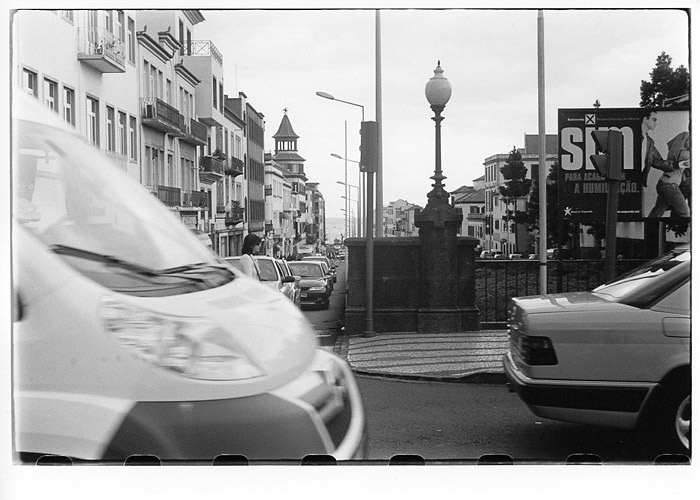

I'm seeing such weaker density spots on my 35mm negs now and then. Lower left corner in the attached image. It is a scan from a straight print.
The spots are usually evident only in larger areas of uniform density, such as overcast skies. They look just like minute drops of water left on the negative after wiping. As they appear only on sloppily washed negs, I've imagined that the stain might be caused by some chemical trace (fixer?) left on the emulsion surface to "eat" some image silver during drying.
I dry my films in the darkroom, where humidity is high and temperature low (during the night). Even in the summertime it takes well overnight until the negs are completely dry.

If anything 'eats' silver, the resultant spot on the print would be darker.
PE
That exactly is the case, both in Janet's sample and in mine, lower density on the negative. I'll look at it in detail on my part and then report back.

It could also be less development. We cannot be sure at this point, but 'eating' the silver is slower after it is formed.
