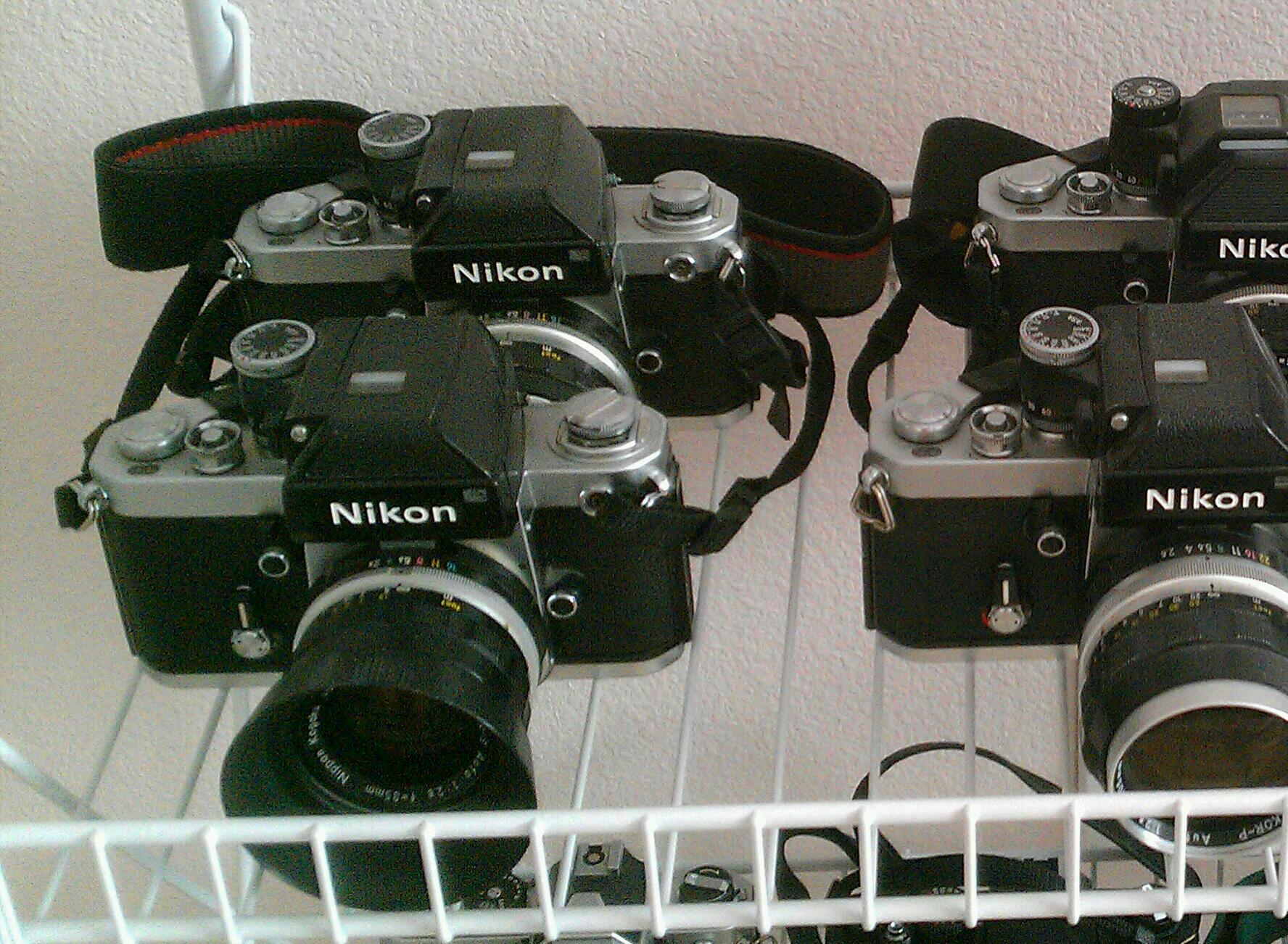

Nikon F2 Photomic
You can tell by looking at the max aperture readout window up and to the right of 'n', the lens release button, and the rewind knob plate. Oh, also by the shiny small flash pin on the side of the Photomic head.
