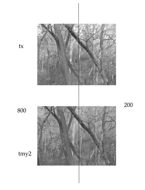

hi hudson
sometimes you really don't need to change the way you process the film and you can
just add or subtract a stop of light when you take the photographs and process "normal"
without extra ( push ) or less ( pull ) development.
a couple of years ago someone asked about exposing a 400 film to 800 and processing normally
it was suggested you could over expose or under expose 1 stop and process normally
and it is stated by kodak that their film can do that ..
here are 2 sheets of film ( tmy2 and trix ) both processed for the same time at the same time
both exposed 1 after the other... i covered my lens with a card and exposed on side at 200 and other at 800
its not a perfect test, the film in both cases was expired and not fresh, and i didn't make prints but quick scans
but as you can tell both sides are passable and hold an image.
its often suggested that with a new camera, new film and new developer the user/photographer
take a few test rolls ,,, meter and bracket exposures and developing to decide what they want rate / expose their film at
so it fits his/her methods of work ... to test the meter ( sometimes they are inaccurate ) and to test shutters ( sometimes without a cla they can be "off " )
and how the developing end of the process works.
have fun
john
