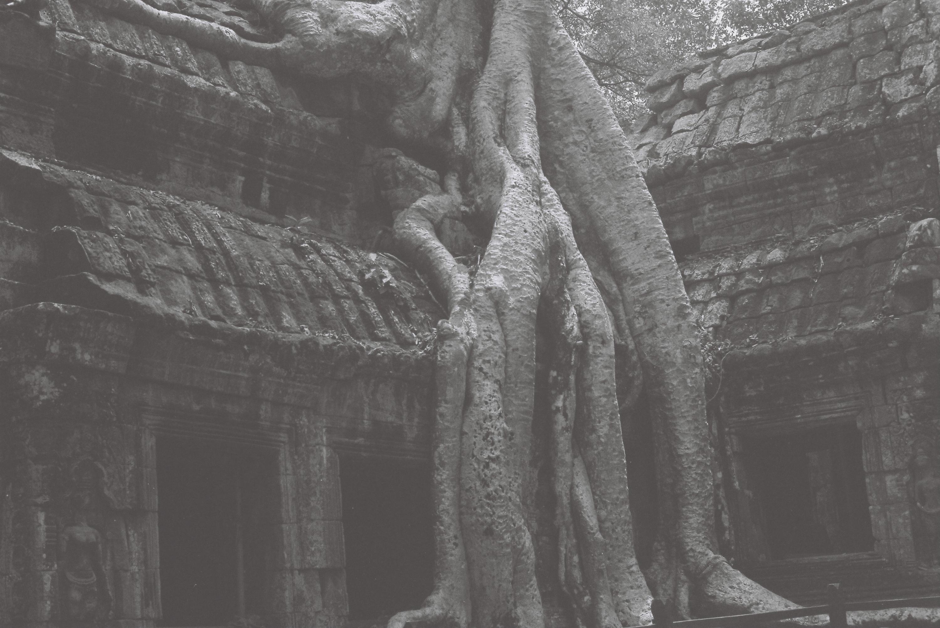

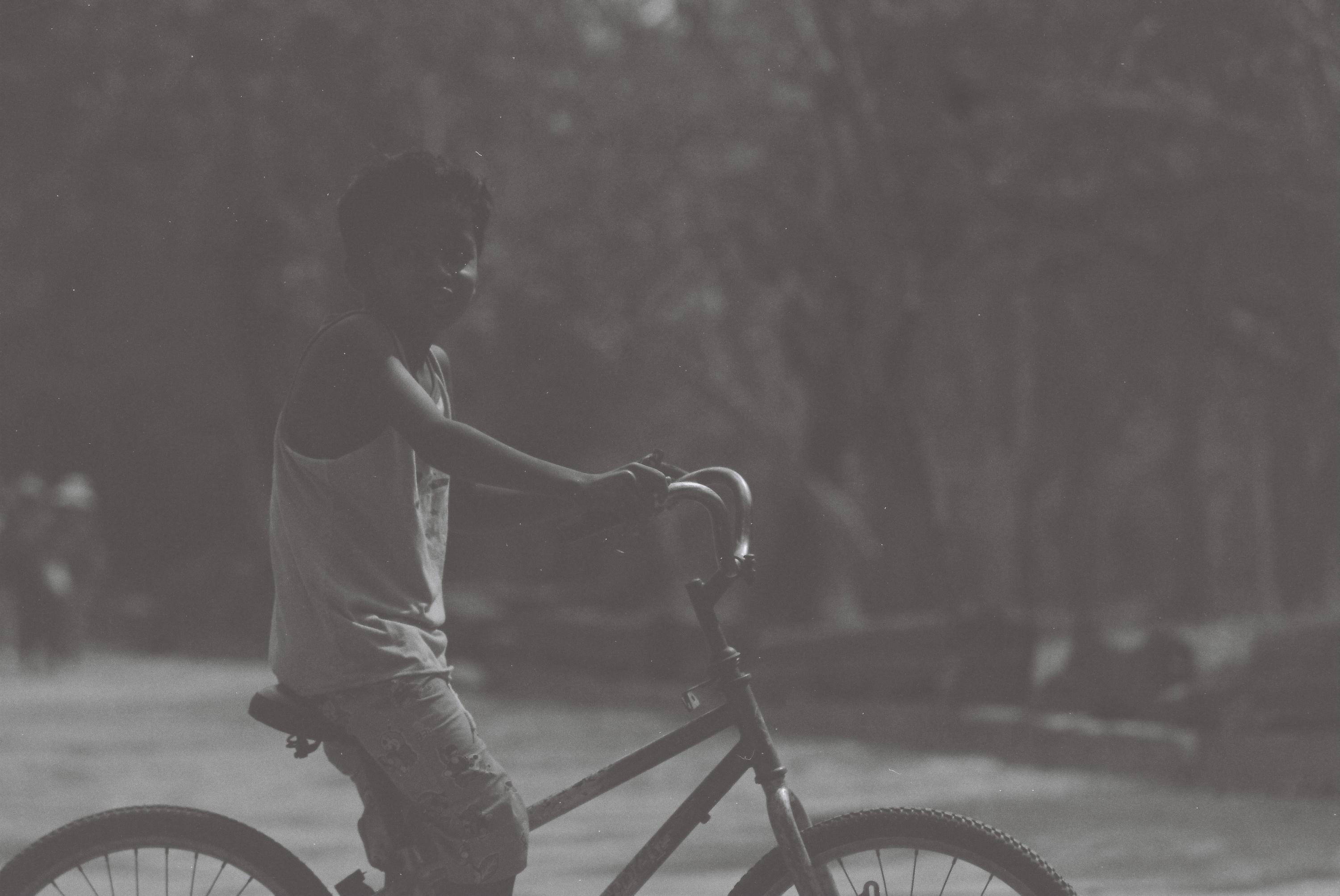

Sent 2 rolls of Ilford Pan F 50 to a lab to be developed and scan and the photos came out without much contrast and just looked very grey.
What went wrong?
I'm very new to film so if some of you could enlighten me that would be great.

You scanned or they did?
Either way, it's a bad scan.
The black point (ie the blackest part of the image) needs to be set a lot lower (blacker).
Ditto the white point, needs to be set a lot higher (whiter).
Then the rest of the tones will fall in between black and white, not between grey and greyer as they are now.

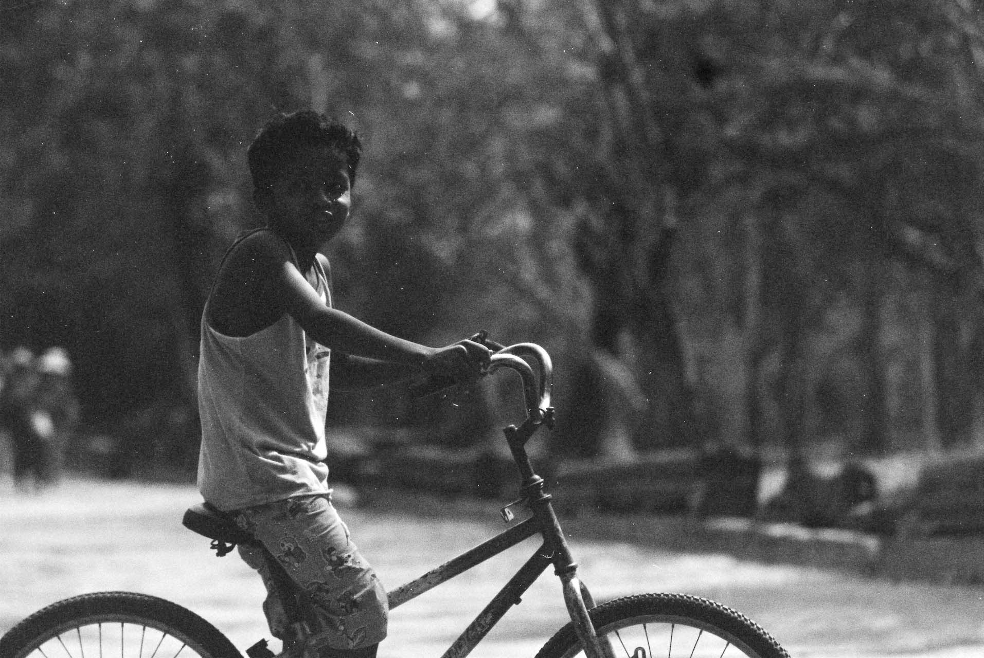

Making simple black and white point adjustments (research this on DPUG or elsewhere with more info on scanning) show the shot with the boy to be underexposed (if you were wanting his face to be properly exposed) and the tree image to be correctly exposed.
Hope you don't mind me posting these slightly edited versions.
Those very quick fixes make a lot of difference.
The photograph of the boy is definitely underexposed. You need to learn how to properly expose those shots, and when you learn a film you can either do a film test, or at least bracket your exposures until you see what you want or need.
His face is almost entirely shaded, and since it's meant to be a portrait, that works against this photograph.
The tree photograph I actually think is better because it is underexposed. Those featureless shadows are not bothersome at all, and accentuates the form of the tree quite nicely. Here it works, even though it was perhaps not as you intended.
