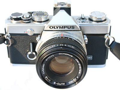

Just curious... I noticed by chance that the OM-1 style of camera is almost identical to the Pentax MX camera in looks. I understand many of these cameras look alike, but I mean they look almsot like clones of each other.
Coincidence? Licensed copy?
What are the differences, if any?

Well, I realize a lot of the cameras all have similar base layouts. However these two REALLY look alike. A small switch on the OM-1 by the rewind is the major difference visible. Although, as posted above this, there's the shutter speed location. I didn't realize it was on the lens mount for the OM series. That answers my question I guess.
Example of how closely they resemble each other:
