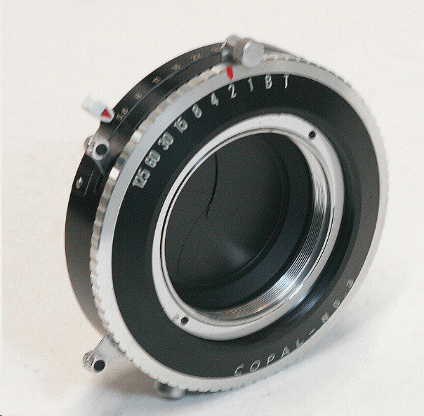

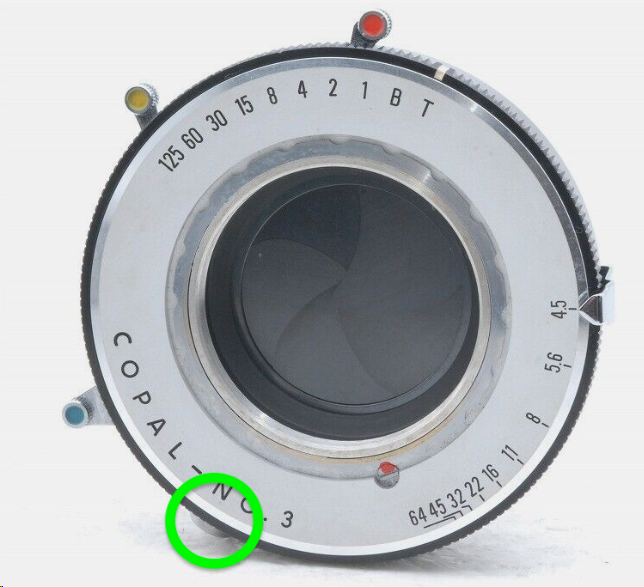

I'm not familiar with the white-faced versions; just wondering what makes them different. No PC connector for flash?

I don't know about the insides of the whiteface one, but you can see the insides of the blacface one here:

The white face should be easier to read in dim light but more reflective/viewable in reflections captured.

The black-faced one is the old Copal 3S, different from their latest version 3. The white-faced one is even older than that. 3S shutters have three levers projecting levers instead of 2, as well as older multi-bladed apertures. And they had a slightly different thread diameter than the later Copal 3. But all of them are simply labeled, Copal 3.
