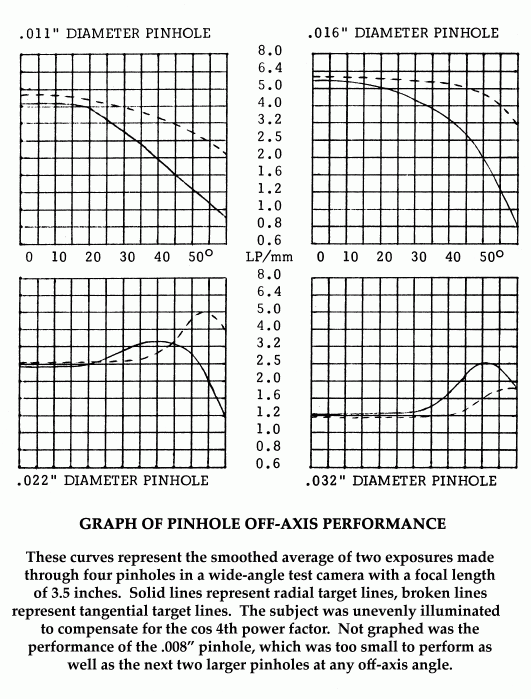

Seen from under an angle, not from straight behind, a circle appears as an ellips, is smaller.
Make the hole ellips shape, and from the side the long axis points to, the effect is negated. But only from that side, and only at a certain angle/distance from the image's centre.
I don't know how that would creat astigmatisme, except that the shape is echoed in the pencil of light's shape. But that's not astigmatism.
Here is the results of off-axis resolution tests done decades ago. Notice the difference in off-axis resolution between tangential and radial target lines. Perhaps this isn't astigmatism, but the results are the same. According to Pinhole Designer with a user constant of 1.5, the pinhole for optimum on-axis resolution in this test would have been .013 inches.

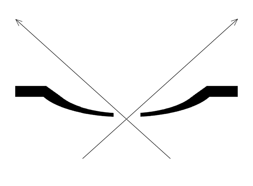

I'll go with that. In my own pinhole creations I strive for a clean, round, and very thin pinhole. This has improved my images. I've attempted this with aluminum foil, but ultimately I end up using thin sheet brass. I found that examination under a microscope is necessary to insure there are no entry or exit burrs, and that the pinhole is as clean and round as possible. Black seems to be the color of choice. I have read that blackening the hole with soot from a candle can help absorb light energy that would otherwise be reflected off the inside surfaces of the hole. For my own purposes I've blackened the hole's inside surfaces with black ink. I have included a basic diagram of a pinhole of my own design that has worked quite well so far. If anyone can use this or improve upon it, please feel free to do so.
