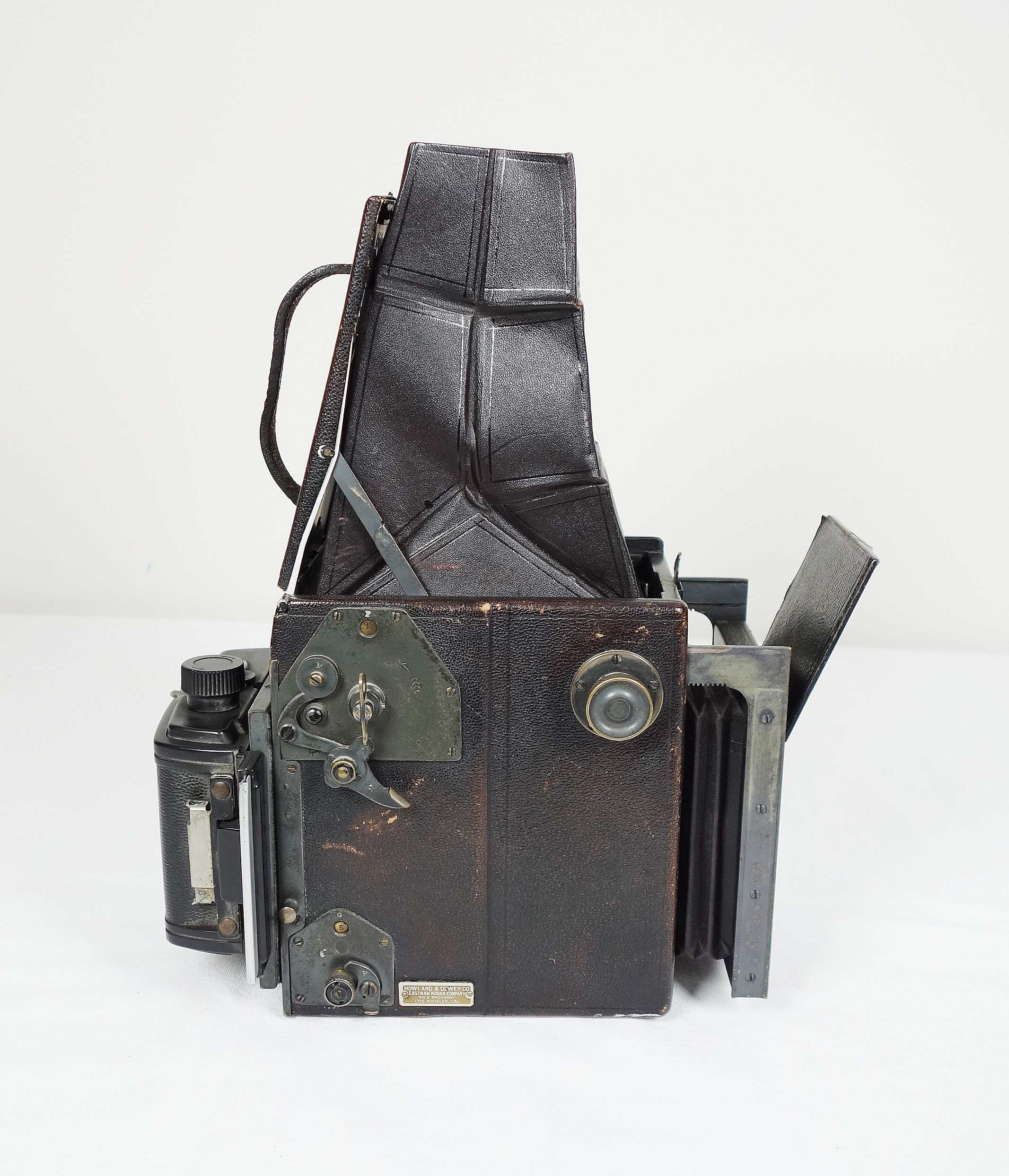

What kind of back is needed to make this usable? Can it be converted to Grafloc back without jumping through hoops?

I think I found my answer. It appears I just need a film holder made for this model. Forgot about it being an slr and no need for ground glass focusing.

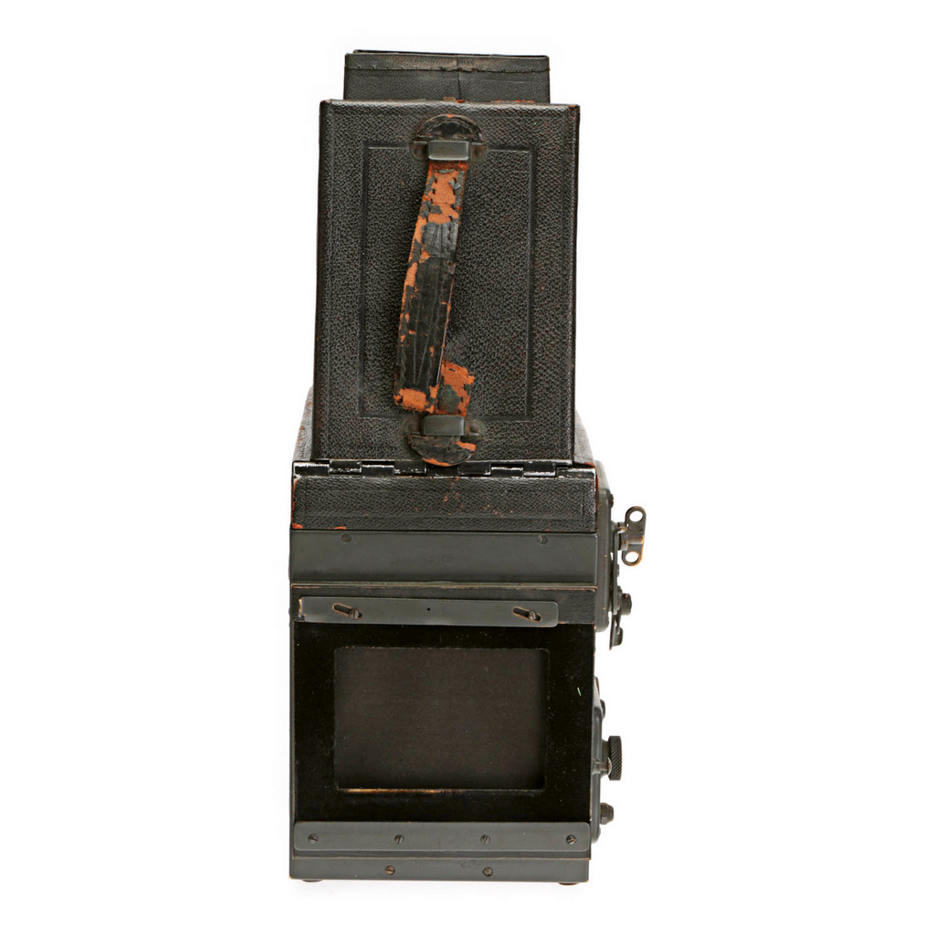

What you have there is a Graflex back; standard film holders are for the Graphic back (aka spring back) and won't fit that one. Wood film holders can be converted if you have wood shop tools, or you can usually find a few Graflex back compatible film holders, bag mags, even sometimes a Grafmatic on eBay.

Based on what I've seen from Ari Jaaksi (YouTube channel "Shoot on Film") all that's needed to convert a wood Graphic film holder to Graflex is to make a compatible groove where the registration rib is, and cut grooves in both long edges to accept the Graflex lock slide. This is probably also possible with plastic Graphic type 4x5 holders, but I haven't seen it done so I can't say for sure.

The format back of that camera does not look quite right in the picture for a 4x5, are you sure its 4x5 and not 3 1/4 x 4 1/4?

On looking back at the first picture, I agree -- Series C instead of D?
I measured once and the distance from the mounting face of the film holder to the film plane is different. I can't remember if the standard holder is taller or shorter, but I deemed it not feasible to convert one to the other, and I have a full woodworking shop to make anything.
With the SLR focusing system, the back flange to film distance needs to be correct.

Or, if you don't expect to ever find the correct film holders, you can adjust the position of the reflex mirror or viewing ground glass to match the film plane. Probably better to shim or thin the film holder frame as needed, though. If the Graflex holders are thicker in that dimension (as they might well be), a suitable shim glued to the contact surface of a Graphic type accessory should fix you up.
Ari Jaaksi gets good results, so he must have either adjusted his camera(s) or adjusted his film holders as needed...

Ah, Series B, then. Definitely convert to Graflok if possible -- that would let you use RB67 and Graflex roll backs as well as 2x3 Grafmatics and standard film holders.

I was curious about the differences in 4x5 holders between a standard film holder and a Graflex. The standard holder distance from the face that goes against the camera to the film is 0.200". A Graflex holder is 0.230". So material would need to be added to the face of a standard holder to bring the film to the proper distance away from the mounting face.
The Graflex holder is also 1/4" wider than a standard holder, no doubt to accommodate the side slots.

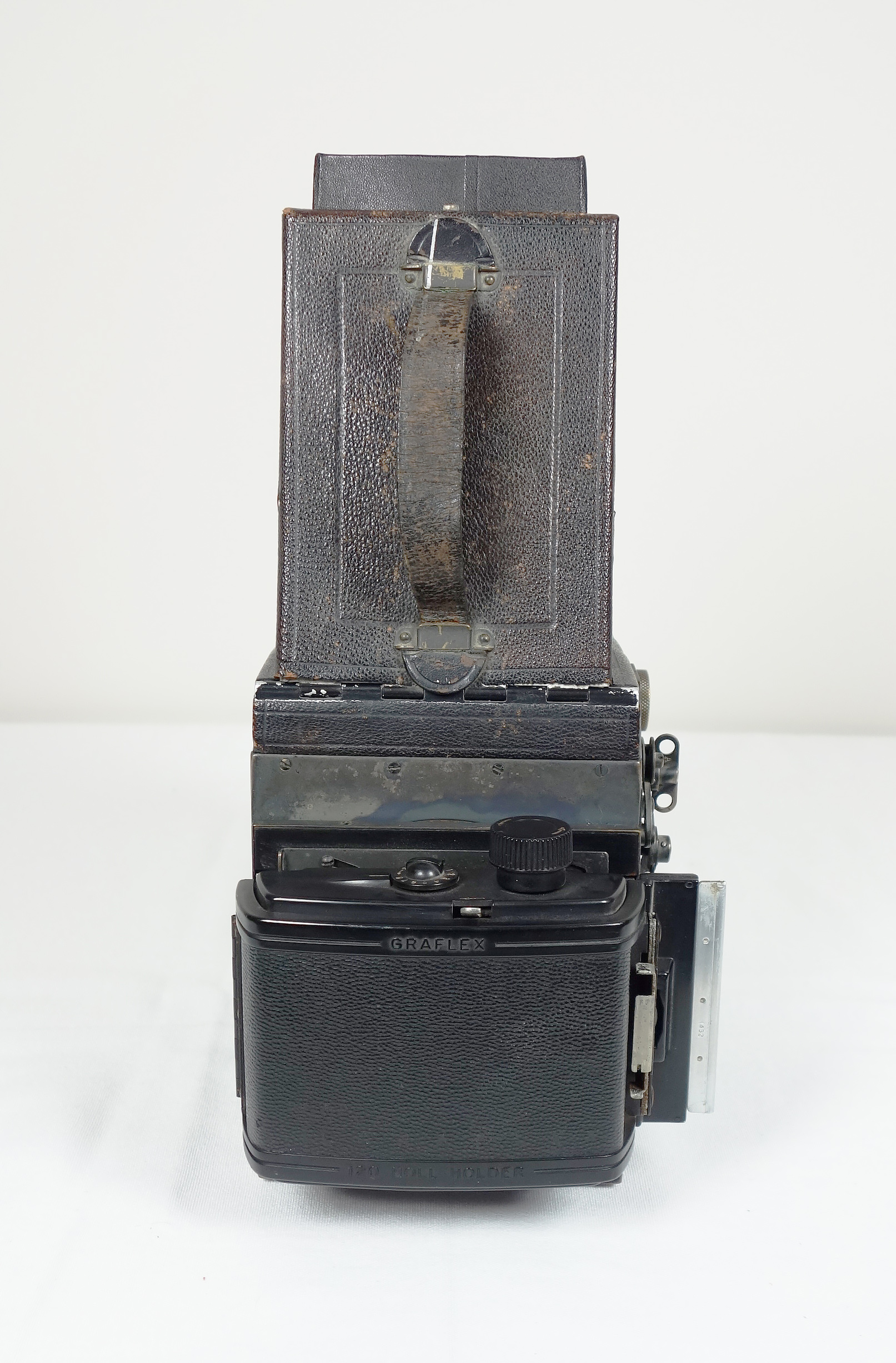

I called and they measured. I guess it's 2x3
Your camera is a Graflex RB Jr, which shoots 2 1/4 x 3 1/4 images. Rather than looking for that size sheet film (and hard to find holders), your best option is to look for a Graflex 120 roll film back to fit it - than you can shoot 120 film until the cows come home.
Here's what an RB Jr. looks like with the 120 back...
