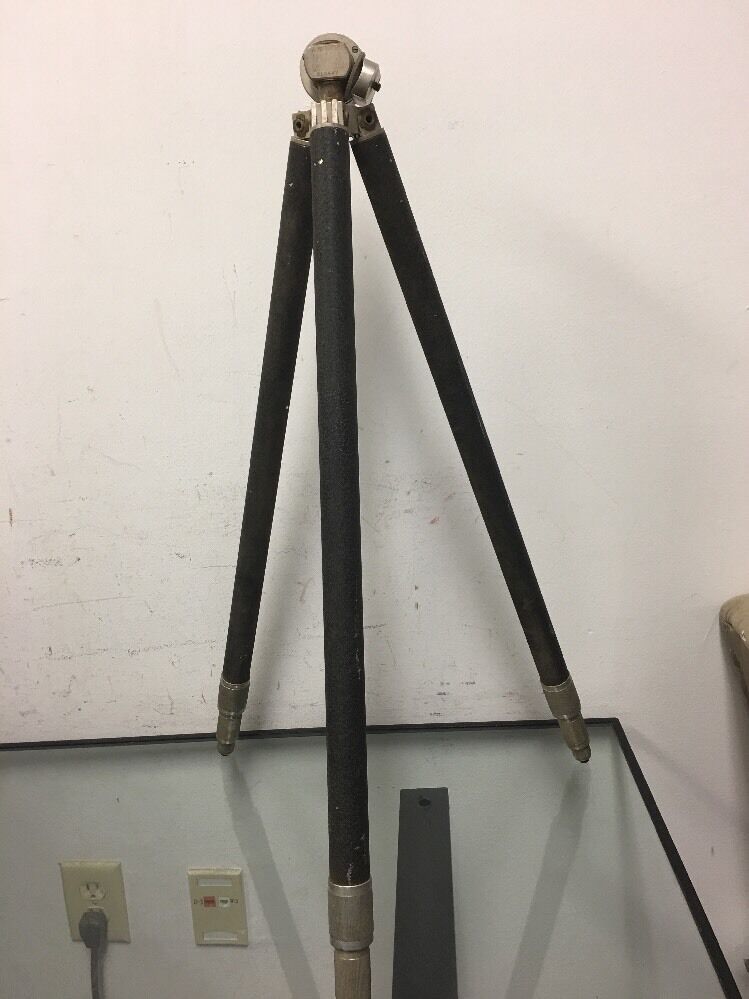

I have a Bolex tripod, made for a movie camera, so short as compared to most still film camera tripod, works for my Yashica 124 and D with waist level finders. Mine is different model but very close.
