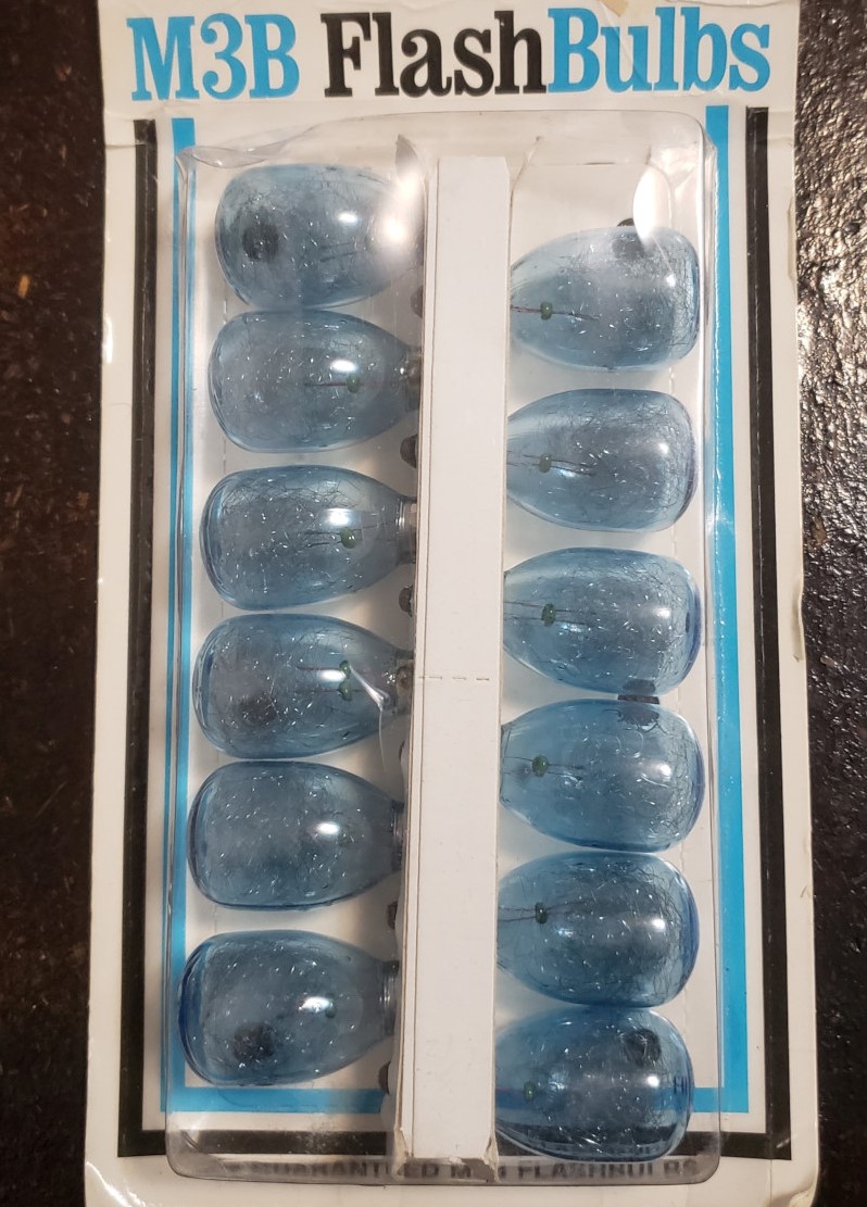

I'm sorry if this is a stupid question but would the flashbulb be more likely to shatter?
It's a GE M3B flashbulb.

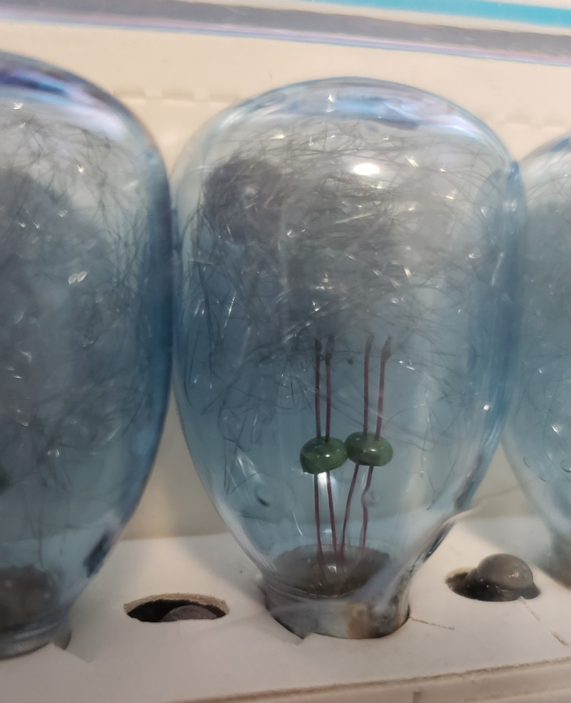

To me it looks as if there is smoke coming from the base!
As there is no safety-indicator dot from the start, chances are that the glass may fracture at combustion due to leakage over time. Furthermore one may not be sure whether there is a safety coating over the glass, preventing shatter in case of fracture.
I have no daubt that it would fire.
In case of portraiture or indoor use I only would use it with a safery screen over the reflector

It still does have a blue dot but my concern was that it has four wires instead of the usual two, just a factory mistake I assume.

How embarrassing, I was that much puzzled by that "smoke" (still enigmatic to me) that I did not realize that "double ignitor".
Well, we do not know what battery or what capacitator you use. We also do not know what way the two filaments are soldered-in. Most likely they are soldered-in in parallel. What is the least electrically stressing alternative.
In case your question implies that you expect something spectacular to happen, it won't. The bang comes from the metall-wool filling, not the ignitor.
I would not try to ignite it, but make it a shelf-queen.
Thanks for your reply, I was just worrying over nothing.

I did not even realise that double ignitor when put right up tp my nose so to say. How did you discover that?
Recently I discovered one dud lamp inside a Magicube that still was virgin though its firing pin had been released. Something I realized at whiping it off and a glance at ots bottom.
