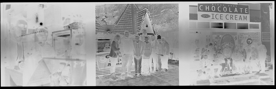

Recently I've developed two rolls of Tri-X and they both had the same problem. The center section of every frame is strangely washed out. Sort of looks like a light leak but in the center of the film strip rather than on the edges. The first time it happened I thought is was due to a mistake I made, applying hypo clearing agent a second time when I meant to apply photo flo. But then it happened again with the next roll of Tri-X when I didn't make any mistakes and now I'm wondering if the film has been damaged. The film is a bit old and has been thru several airport xrays. I've developed several rolls of Fuji Neopan 100 Acros with the same process and don't get this problem at all so I'm pretty sure it isn't an error in the developing process. It shows up on every frame of the entire roll.

Can you show us an image of the negatives themselves?
My guess is that your fixing was too short or the fixer is exhausted. If so, re-fixing in fresh fixer may help.

Thanks for the comments. I fix for 6 minutes with Kodak fixer and it seems to work fine for Neopan 100. I have a gallon of fixer that I use 500ml at a time and return the fixer to the gallon jug. This was my 10th or 11th time to use it so it shouldn't be depleted yet. But I could try longer fixing times.
As for the fogged camera lens, that isn't likely because I've gotten identical results from two different cameras, and gotten clean results from the same two cameras using other film.

Underfixing should be evident as milky areas/blotches when looking at the negative against a light source. It usually can be corrected by refixing the film in fresh fixer. If this is not the case ...
Has this film ever been in checked baggage while you were traveling? Normal carry-on baggage X-ray scanners do not harm film, at least not unless they are scanned more than half a dozen times or so. But a single pass through a checked baggage scanner is very likely to fog your film and the sample pic you have posted could be seen as rather typical for that type of damage, especially given that is present across the entire roll, as you indicated. See the Kodak publication below:

wow, if it is xray damage
it is the first time in 35 years i have
seen damage from X-rays ... bummer ..
if its not the dreaded xray
maybe its light leak ..
now sure what format film
or camera type is used but
across the roll in the same spot
bleached out like that
would be a dark ness throughout the whole negative
are the clear parts between the frames ... not clear?
can you upload a untweaked negative strip ?
happy holidays !

In my experience under fixing tends to be more blotchy/mottled. Looks like the film was fogged....somehow; the fogging is very evenly distributed. 6x6 if the image is representative.

So here is a scan of the negative, unprocessed.
I'm not sure how many xrays the film has been thru but I'm pretty sure I've always had it in my hand luggage.
I'm going to try fixing this film a little longer, although it's already been a couple days since I developed and dried it.

There is a band across all the negatives which can imply fogging or not fixing [using hypo] long enough.

Here's an update. I refixed the film, giving it a good 15 minutes or so and then re-rinsed and dried it and now I'm scanning it, but from what I can tell looking at the negatives, the foggy band in the middle appears to be gone! I won't know for sure until the scans are done but will keep you posted. By the way, I forgot to mention that the film is 120.

You folks are the BEST! Negatives came out looking very clean after the additional fixing. Scanned negs are coming out perfect! I will be increasing my fix time to 10 minutes or more for the next rolls.
So here's a question: why does Tri-X 400 require more thorough fixing than Neopan 100? Any ideas?
