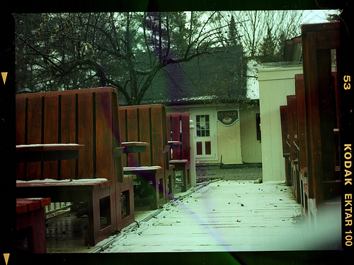

Another C-41/What Went Wrong thread -- but in this case, I'm 99% confident it wasn't a processing error. Have a look.
attachment.php
So this is expired Ektachrome, cross-processed in C-41 chemicals following the standard routine: 100F for 3:00 (pulled slightly on purpose), stop, rinse, bleach, rinse, fix, rinse, stabilizer. I developed a second roll of the same film at the same time, and it looks absolutely fine -- even development, good density, etc.
If I had to guess, this particular roll of film got wet or otherwise contaminated (what are the spots in frames 29, 31 and 34?). Any ideas? Thanks.

summicron, look at the weird patterns, which are especially visible in frames 25, 26, 32 and 33.
bvy: can you tell us which chemistry you used?

I used Kodak Flexicolor developer (mixed fresh last month), Kodak bleach, fix and final rinse.
I got the film from an APUG-er a while back, so I can't speak to its history. I can say this was the fifth of the five rolls I got and the other four came out fine. Here's a frame from one that I printed a while back:
attachment.php
Since these were expired when I got them (and I had planned to go through them more quickly than I did) I never refrigerated or froze them. They were stored in a cool, dry area -- or so I thought.
No great loss. It's a matter of curiosity more than anything. I agree some of them look cool, though it's not the kind of cool I was after. I might actually try to print frame 24.

Is the whole roll like this, or just the final frames? Is there a chance that the roll wasn't completely wound up, and that the final dozen frames were just wrapped around the spindle?

These were processed in a Paterson two-reel tank with 600ml of solution. The bad film was on the bottom. The whole roll is like this, but the last third (shown) is where it's the worst.
I considered that the film might have been spooled incorrectly, but it went on and came off the reel smoothly (and these frames were on the outside, not near the spindle). Even so, if that were the case, I wouldn't expect to see the problem all the way to the edge of the film. For that, I would have had to have spooled two strips of film onto the same track; I think that would have caused some resistance that I would have noticed...

I opened up and compared the two empty film cartridges. The one from the errant roll has the tiniest stain on the tape, and rust on the frayed metal edges (where I separated it). Nothing I would have ever seen had I not gone looking. So I'm going with moisture damage...
