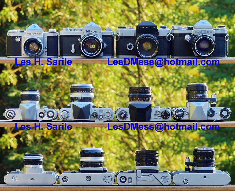

Not an add-on but Canon's first SLR - the Canonflex, used a bottom mounted film advance lever.
First SLRs from each company by Les DMess, on Flickr

The bottom trigger wind lever was popularized with the Leicavit rapid winder attachment. Early Canon rangefinders in the V and VI series were also available with a bottom trigger wind, often denoted by a T in the name (e.g. VT, VT Delux, and VI-T).
The Canonflex cameras had a breech lock mount and was used with Canomatic and Super Canomatic series lenses. They were made from 1959 to about 1963. The next series of Canon SLRs started in 1964 with the FX and FP. These took the FL series of lenses. The FL lenses had the same outer breech lock mount but the aperture pin did not match up with the pins of the older Super Canomatic lenses. The FL line ended in about 1970. In 1971 the Canon F-1 and FTb cameras came out. These used the new FD mount which allowed full aperture metering. Most of the FL lenses could be used on cameras made for FD lenses, in stop down mode. The Super Canomatic lenses could not be used safely on cameras made for FL or FD lenses. Finally in 1979 Canon introduced the New FD line of lenses. These would fit cameras made for FD lenses but would mount in a bayonet style rather than a breech lock style. New FD lenses could also be used with cameras made for FL lenses, with metering done in stop down mode.
Thanks @dynachrome! I thought maybe Canon 35mm SLR lenses were all the same, mount-wise, up until the introduction of the EOS mount. I appreciate the clarification.
