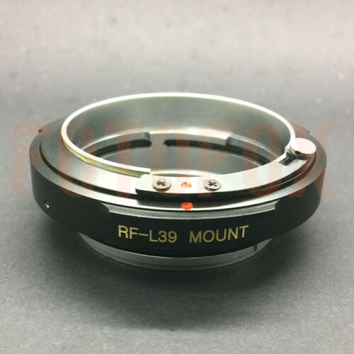

I do see some Contax to L39 mount adapters that at least appear to intend to couple the RF -- but on eBay it's hard to be certain.
And of course the S2 has the same issue with Contax mount lenses as all the other Nikon RF bodies. If I want a fixed lens, I'll use one of my several fixed-lens rangefinders (two Canonets, a Petri 7s, Signet, maybe one other I'm not remembering). Or one of my RF folders, 35 mm up to 6x9...

The other option- buy an inexpensive adapter and an LTM camera.
I bought two of these. These adapters have set screws to position the external mount with the lens. For use with my KMZ Jupiter-9 I had to file part of the mount, there are subtle differences -mostly tolerances- between the Contax and Jupiter lenses. Same tolerance problem- you might need to remove the chrome trim around the Jupiter bayonet mount and do some filing so it does not dig into the faceplate of the Nikon.

The rangefinder coupled adapter for Contax to m39 is the Amedeo adapter.
I was looking at those eBay adapters and thinking it certainly looks like they tried to make them work with the RF coupling. I'd guess they're Chinese copies of that Amedeo, though I've never seen one of those.
Either way, if the adapter can stay on the body and the lenses mount and dismount as they do on a Contax/Kiev, that plus a Canon 7 might be the answer. Then I can choose whether to get Contax mount or LTM for future lens purchases (a faster 50 is surely in the future -- f/2 is acceptable, but my tiny Weltini has an f/2 50 mm Xenon so it'd be nice to have an f/1.5 or so on the bigger, heavier camera along with the other choices).
