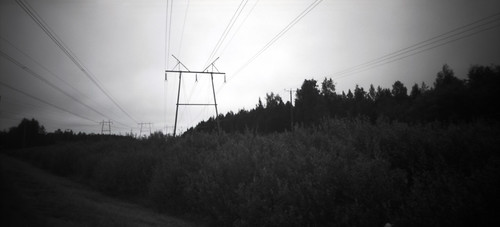

Thank you everyone for you advice. I got the Noon Pinhole camera last week and shot and deved a roll during the weekend. Here's one of the 6x12 shots I took on Kodak T-Max 100. I calculated exposure time based Joe VanCleave's formula (f/R)^2 x Tm = Tc. Because the exposure times were only around 4-5 seconds, I didn't add any time for reciprocity failure.
The shot (click to view larger version):

That's a great looking image. I'm always amazed at the quality of good pinhole exposures onto medium format film.
The forested trees in the foreground appear a bit dark, which is okay actually, but perhaps you might want a bit more detail present; this may have more to do with your metering method than reciprocity failure. You may want to try pointing your light meter at the trees and keep from getting too much sky exposure on the meter. I've come to do this when exposing paper negatives, since the sky gets blown out (i.e. over-exposed) using paper, I'm not interested in capturing detail in the sky, but rather the landscape itself, so I try and meter the foreground itself.
I look forward to seeing more results; great job.
~Joe
I actually like the bright but not blown out sky and forest silhuette. But you're right, I should pay more attention to my metering next time!
