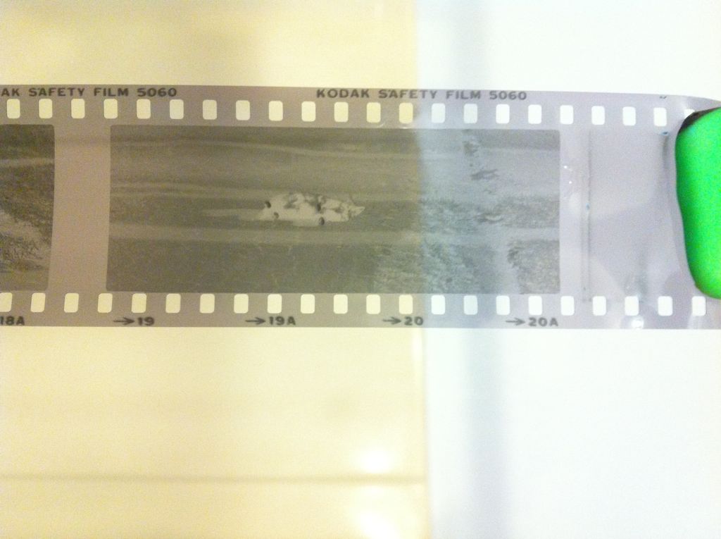

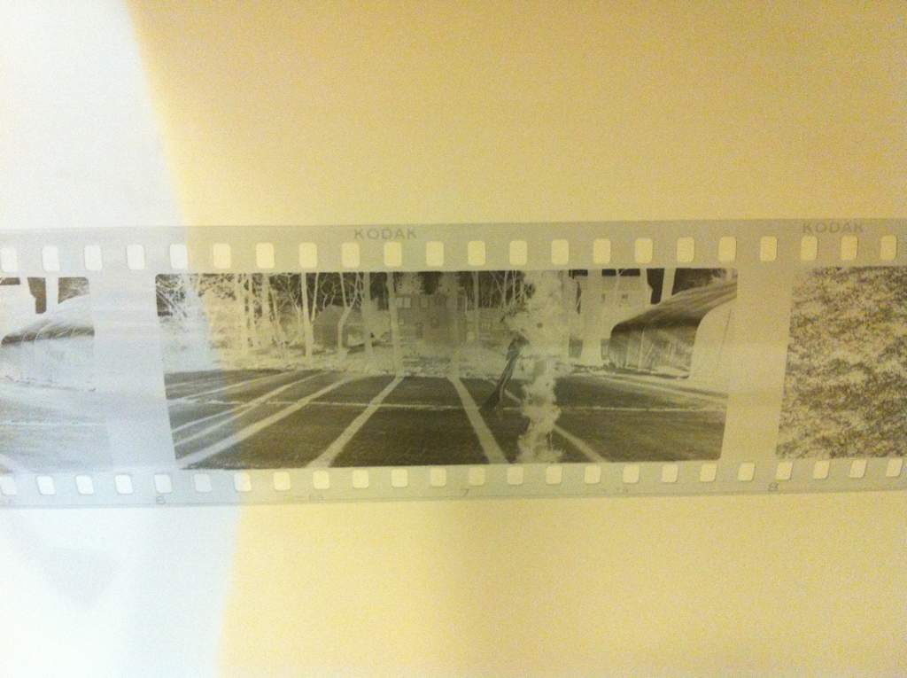

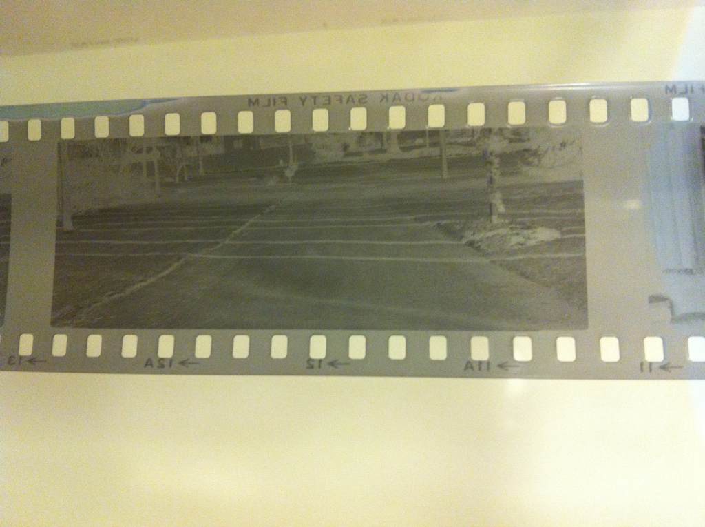

Hey guys, can anyone help me identify this?
I developed 3 rolls of old film together, a roll of technical pan, roll of "recording film" and roll of Panatomic-X all Kodak, the Pan-X was easy because it has "Kodak Safety Film 5060" on it so the number identified it, the other two, one says "Kodak Safety Film" only no numbers, and has some fog like the pan-x but the other one just says "Kodak" and is SUPER CLEAR no base fog at all, so I'm really hoping that's te Tech pan, since recording film was fast 1000ASA and SHOULD have fog, but I got the tech pan off ebay cheap and it didn't look well stored, boxes all beat up, but anyone know which is which? PE??
Panatomic-X
Kodak Safety Film???
Kodak???
Thanks anyone!
~Stone
