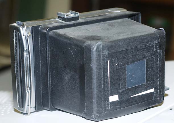

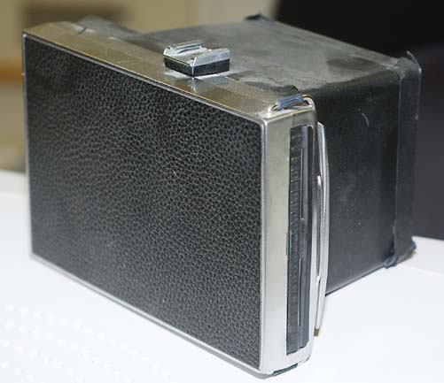

Yes, 665 is smaller than 4X5 film but there are dedicated backs like the #405 that adapt it for most any 4X5 back. The one I'm offering won't fit in a 4X5, it's like a dedicated little pinhole camera complete in itself. Jim
Here's a couple of photos to show what I'm talking about. jg
