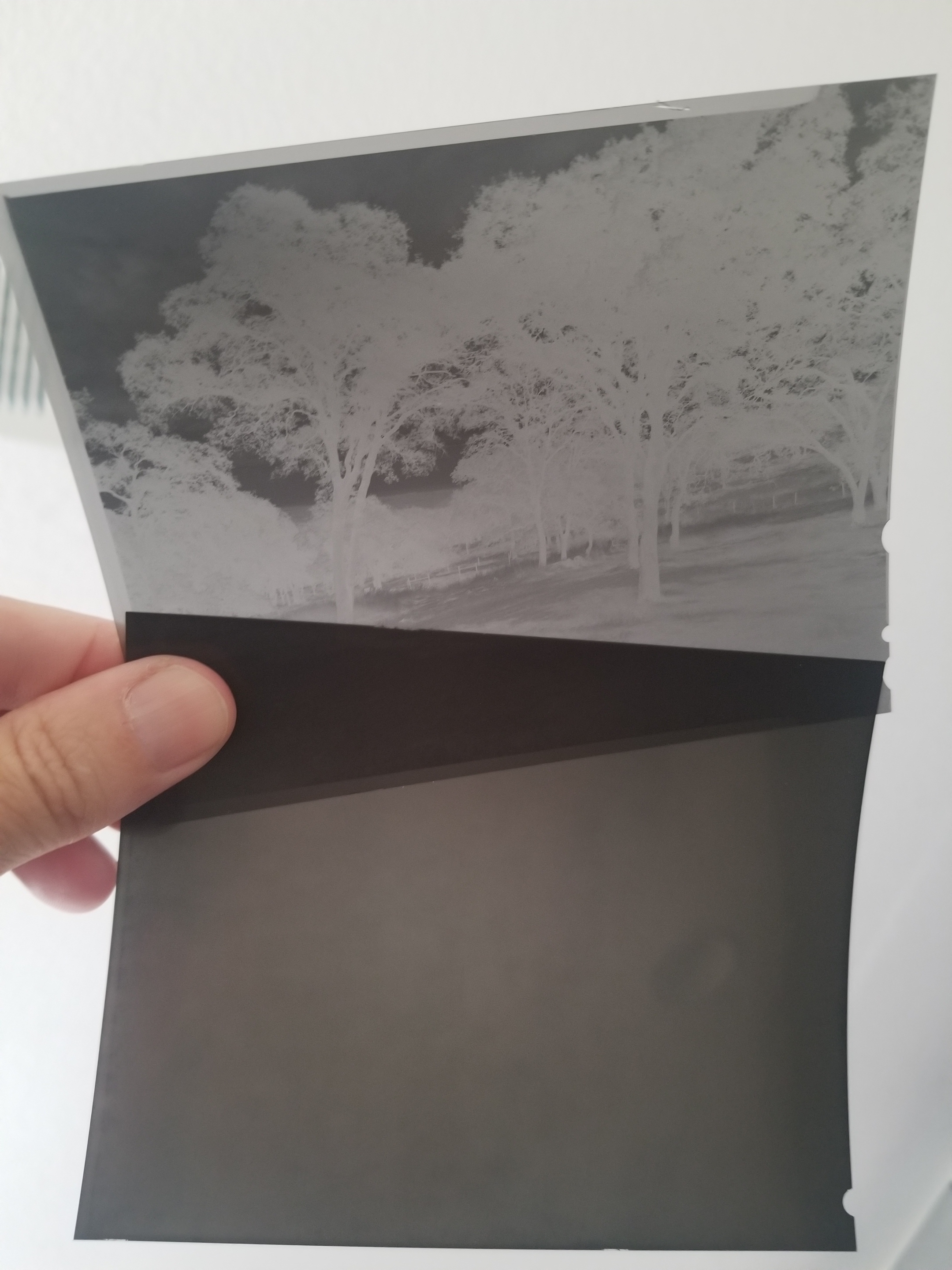

You can see here the bottom negative is the fogged Ortho film. It's fogged it to the edges. I did not expose that sheet at all.
The other sheet is hp5. I developed them together in the same tank. So the issue is definitely not the process.

The box of film was still sealed before I used it. So likely damaged by the heat.
That's a good idea to try the lumen with this film. I will see what I can do and report back. Hmm with the 4x5 film, I could even make contact prints from it.

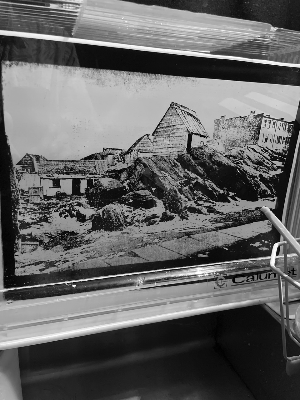

Funny you should bring it up. I did a couple projects with expired fogged ortho film the other day.
The film developed to contrast but had splotchy overall fog 0.3 in several regions.
So I printed through it on Grade 4 paper and you can’t really notice the fog.
Photo is “Shantytown”, the first halftone ever printed in a paper. I had obtained a classroom slide of it (turns out it was reversal Panatomic-X 35mm). And I wanted to print it so used the ortho film as an interneg.
