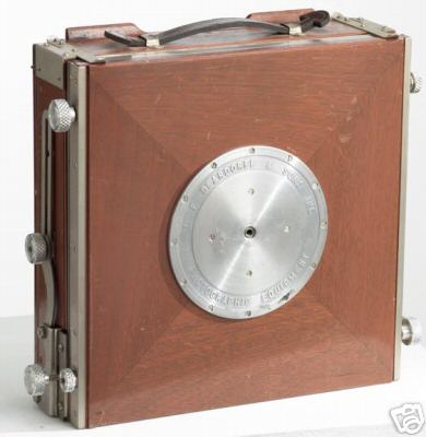

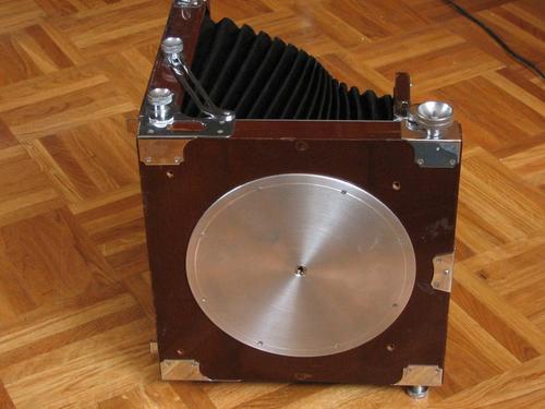

The only remaining problem is the tripod - ie. tripod mount. The existing "turntable" mount is unusable to me as it is. I think I'll get some kind of "Deardorff" base plate made from aluminum - to fit the existing circular hole in the bottom, so that I can use my sturdy Manfrotto tripod. I've been busy all afternoon today, preparing technical drawings with measurements, etc... I was lucky to find an easy to use (and free) software :smile:
Attached are the photos of the existing "turntable" tripod mount, and a photo I found of Deardorff baseplate. Shouldn't be too expensive to have made from aluminum or something similar (and not too heavy)..

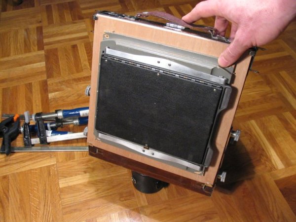

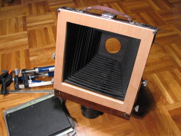

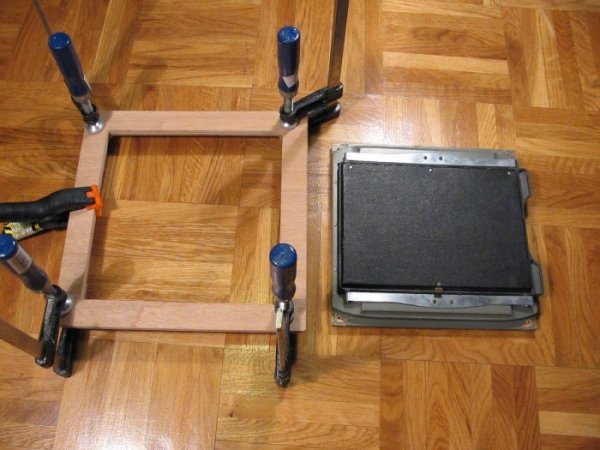

A quick update...
The adapter back is more or less done - just needs the final finish.
Also, I'm still considering options for fastening the 5x7 B&J back to the adapter back.
I'm lucky to have an uncle who's handy with woodworking, and who has access to lots of fancy machinery, so this was in fact done without too much trouble.
Denis

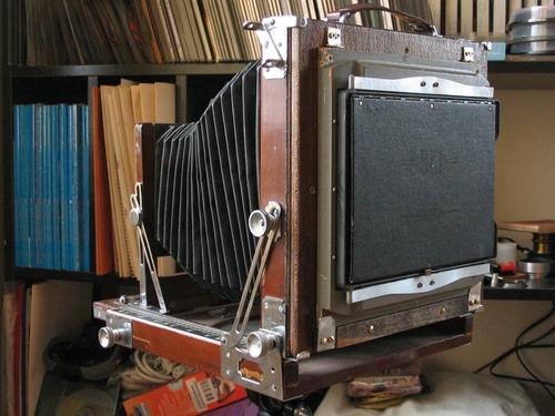

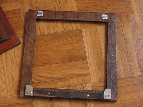

Well, the adapter back (frame) is finished, and the circular bottom plate in the Deardorff style has been machined out of aluminum. The camera is ready to shoot!
The biggest problem was how to solve the fasteners for the existing backs I have - i.e. how to fasten those back to the frame. Finally I managed a DIY solution - I got the idea from small picture frame "hooks"...
Anyway, the photos are attached - I couldn't resist, and added also a photo of the happy owner :smile:
Regards,
Denis

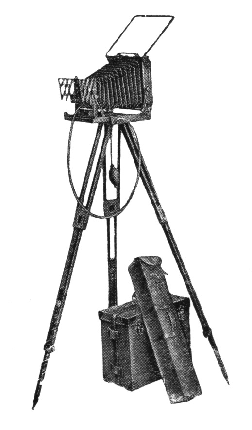

Hi Dennis,
Sorry for being late; and good work you have done.
I managed to find the original instruction manual for the camera (which was actually in the case all along) and have scanned this picture of the camera on the cover, which should give you some idea of what it's supposed to look like.
Interestingly, the instruction book states that it used bevelled rack-and-pinion gears rather than straight ones, on mine they are straight and as mentioned before, the rack gears were moulded out of very poor grade plastics. I hope your example actually complies closer to the description.
All the best!
