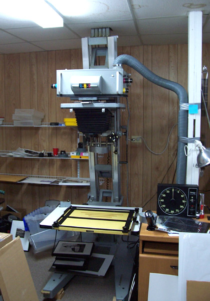

I cut out around a ceiling tile to make mine fit.

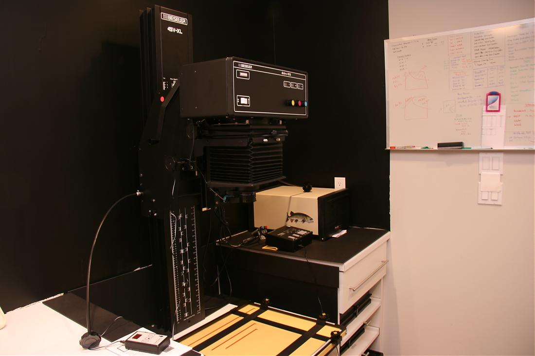

You did not mention the dimensions of your room. Would a drop table work? This is a photo of my setup.

After sleeping on it, I think I have a plan for a drop table.
What I have is a steel table that bolts together and is 32" high. It is in pieces, four legs, top, and bottom. Originally it was used for a drill press. I'm thinking I could make frames of angle iron the dimensions of the base board and bolt them in at the top, bottom, and somewhere in the middle. I could then use the original base board from the D2 and place it at any of these three positions. Of course it would still be bolted to the wall, at least at the top.
I would like to see more images a set up like this. if anyone has the time and could post detailed shots of their drop table it would greatly appreciated.
