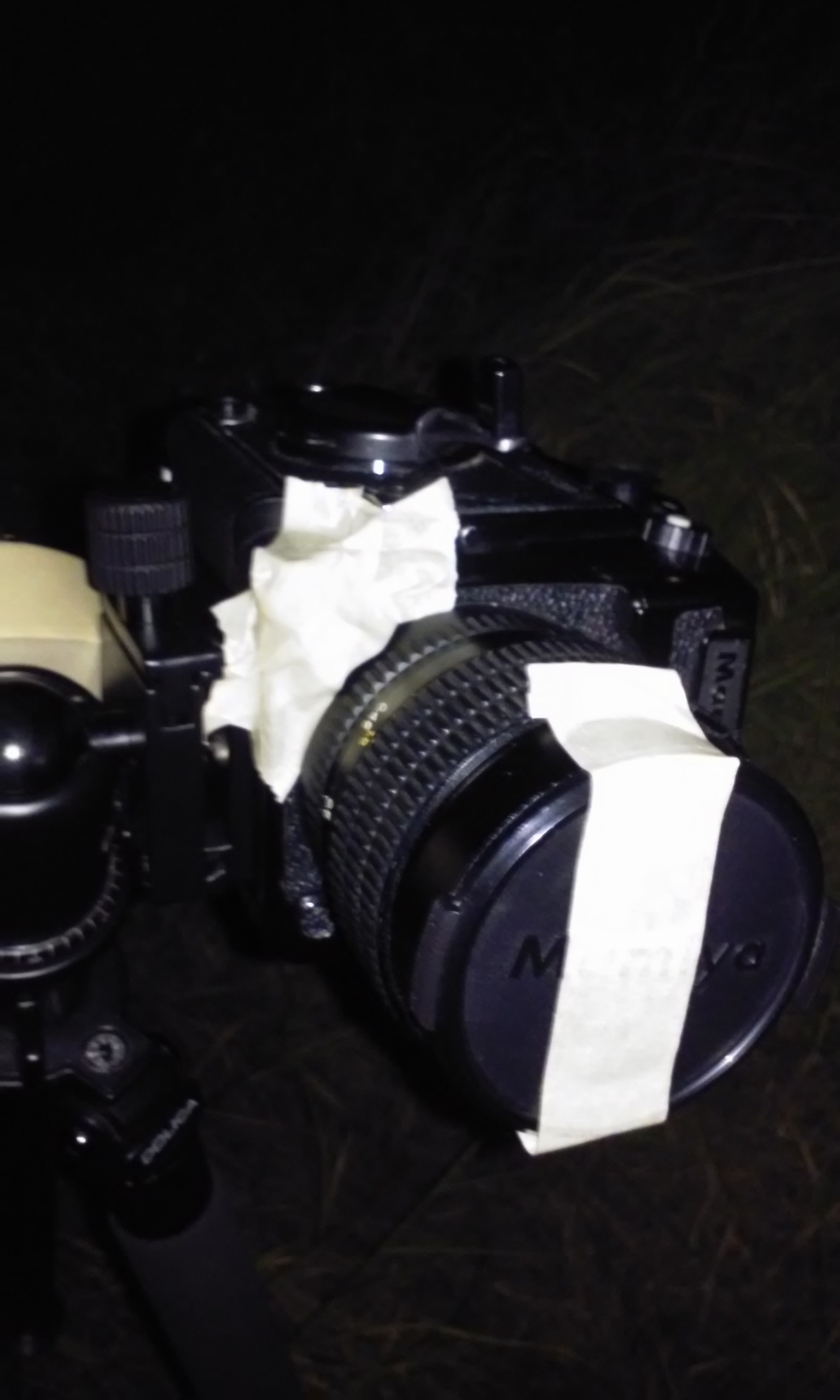

I forgot to bring a cable release with me. When I was packing stuff for the trip, I had one in my hand, but it wasn't the one I like, and as I was going to get the other one, I was called by one of the kids for some help. I then totally forgot about the cable release, and didn't even realize until we were leaving the hotel to head up to the launch. Luckily, there was a Walmart across the street, and I ended up taping the shutter button, and using the lens cap as my shutter.
This is what my camera looked like. I can only imagine what people were thinking about the guy with the camera with tape all over it!
All I can say is, it worked!
