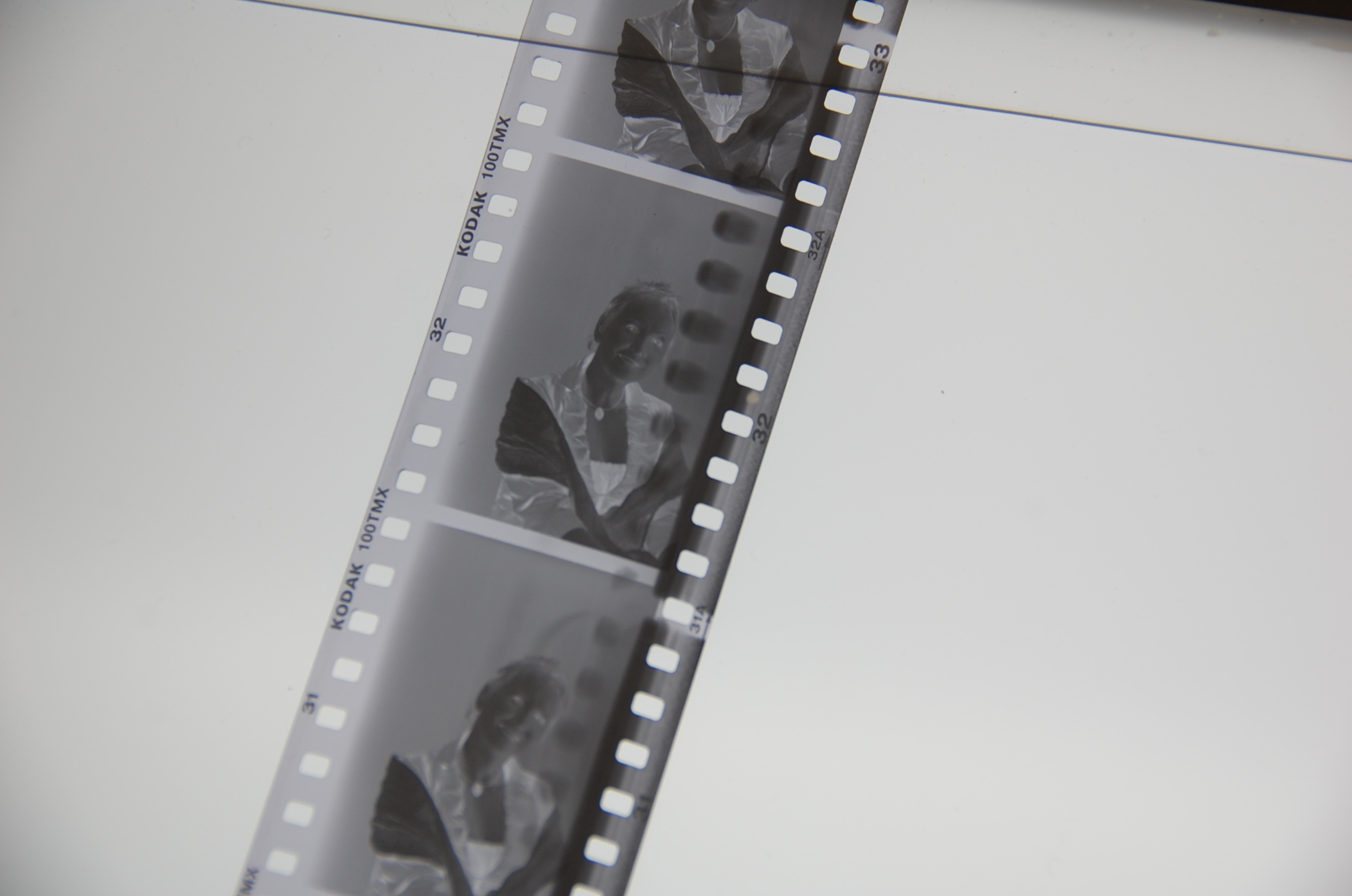

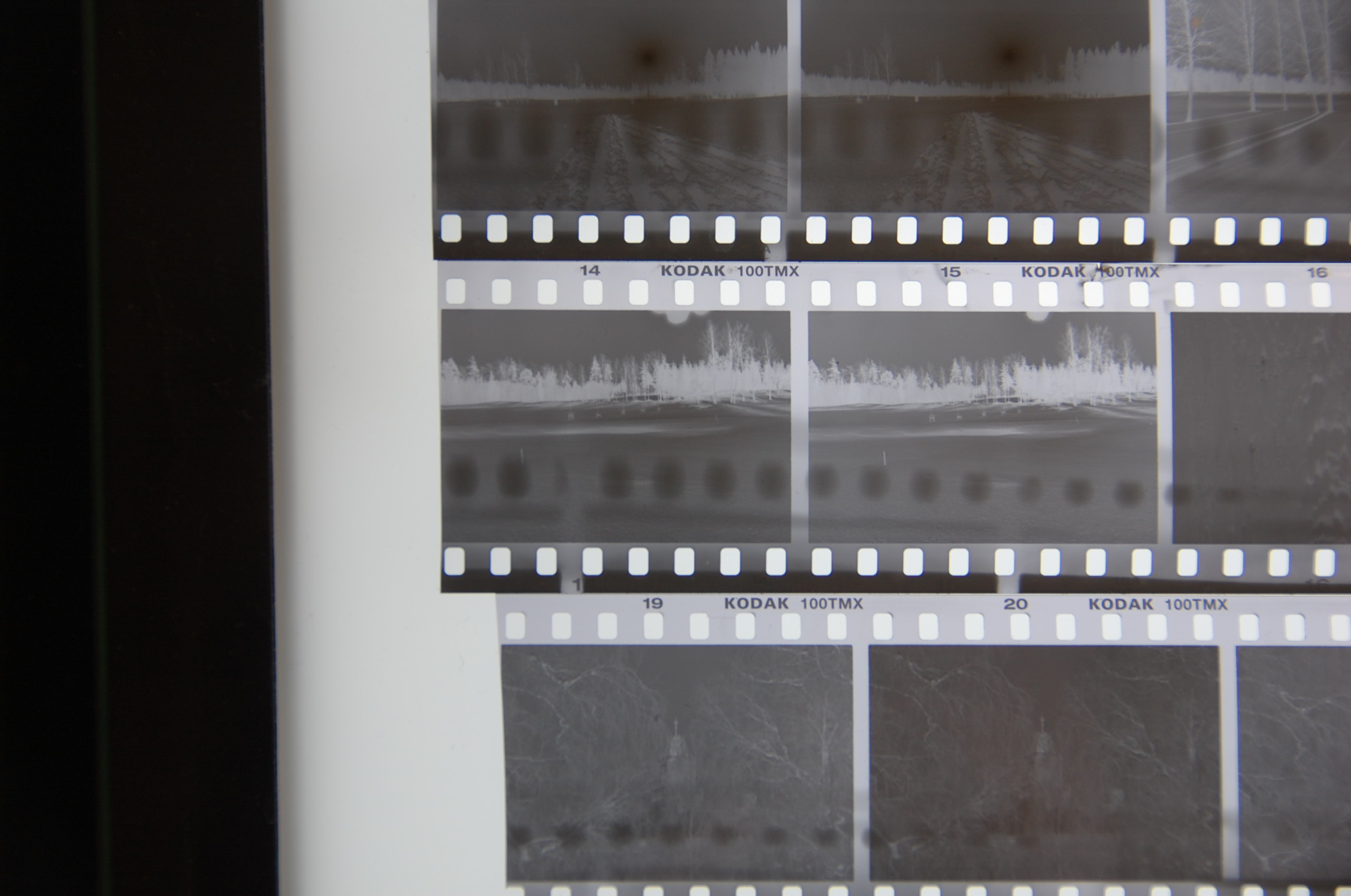

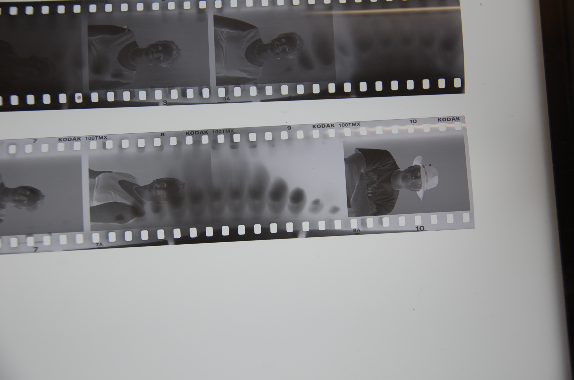

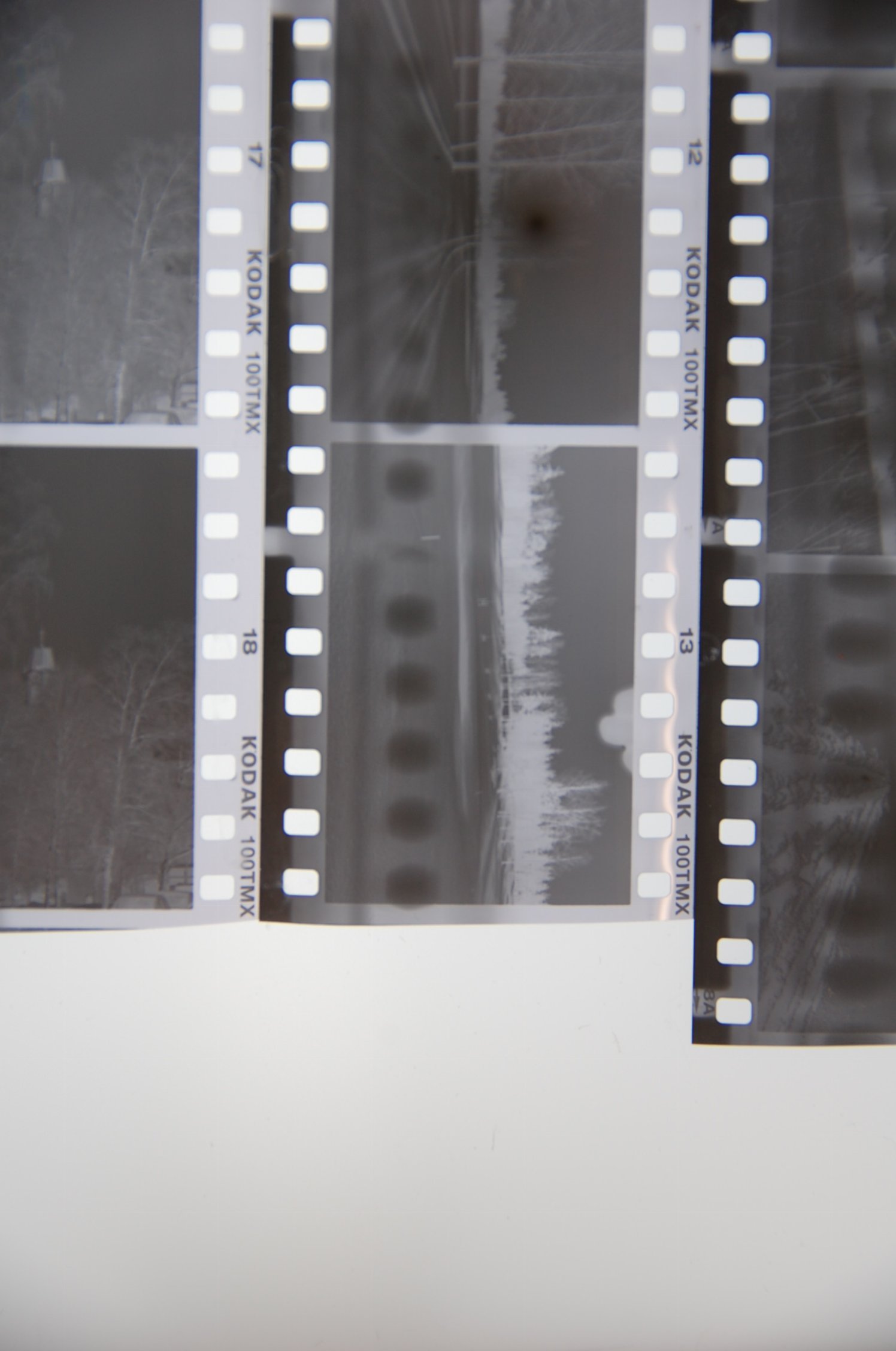

Yesterday i developed 2 rolls of TMax 100. Taken with same camera, Nikon FA.
Developed in XTol 1+1, 8 min, 20C
It looks like the sprocket holes bled in to the pictures. It is not on every negative but on enough to almost spoil a whole roll.
Is it a light leak? Mistake in development? Aliens?
Advice very much appreciated.

light leak during development?
It's definitely a light leak. Check the light but the way it's happened fogging through sprocket holes show it's not happened in the camera.
If you use Paterson tanks it's possible you used the wrong center column, there's two columns that are close in length from different style tanks.
Also was there any chance of stray light as you loaded the films, a small on/off indicator light on an enlarger timer or something similar.
Ian
Thanks. I now know what happened. I intended at first to use a Paterson tank but the second roll stuck (ball bearing) so I had to switch to my SS tank. In the meantime i put the loaded roll inside the Paterson with the lid on but whithout the center column. Stupid me. So light leaked in through the lid as I turned on the light to find the SS tank (sounds like something from a WWII movie).
Ok. Mystery solved. Culprit found. As per normal, I'm an idiot. Silver lining is that nobody paid me for these pictures and the camera is OK.
