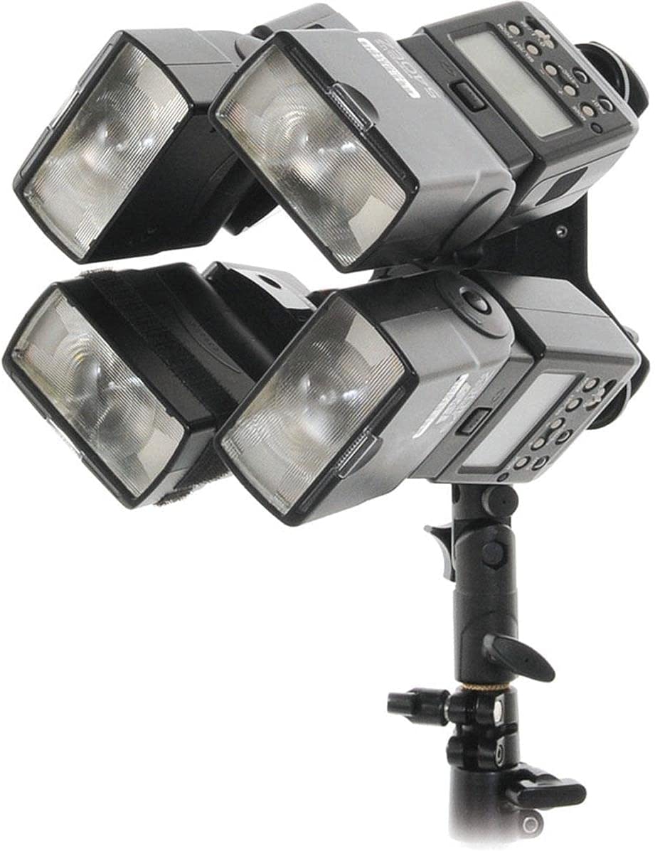

Depending on the speed lights used, this might be a solution to consider:
Or a battery-powered power pack with a separate head (like a Hensel Porty or a Elincrom ELB 1200) that would be lighter and easier to mount on a boom than a monolight.

Not sure what you mean by dedicated flash unit. That usually refers to a speedlight that electronically communicates to a specific brand or model of camera, having automatic functions that sometimes can be controlled by the camera body. I don't think that is what you have in mind for if there are such units for the RZ, the choice is probably severely limited.
AgX
Apr 5, 2007
29,973
Germany
The real issue is how much usable light output you will have available once the umbrella is included in the setup.
Already with a/their standard reflector studio flash lights make different use of the capacitator energy (Wsec). So that value is only a rough guide.
