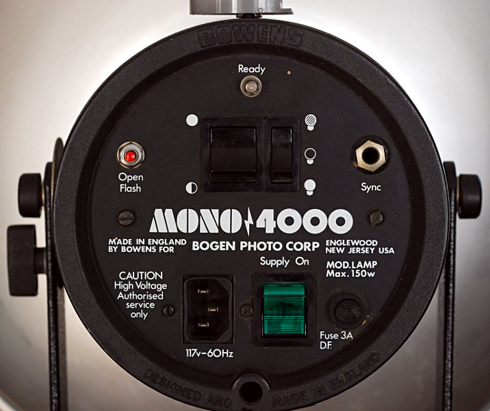

I have an old Bogen/Bowens Mono 4000 monolight I'd like to buy a snoot for.
What is that size fitting called? The protective cap is approx 6.5" diameter, uses two screw bolts on either side of the head to tighten.
I see some inexpensive snoot/honeycomb combos being sold which say: "for Bowens mount studio strobe", but they are not the correct size since they are only 3.9" dia (see as an example: https://amazon.com/Neewer-Aluminium-Honeycomb-Monolight-Photography/dp/B0788MZTRQ/)
I need to know what the correct size is called so I can locate one.

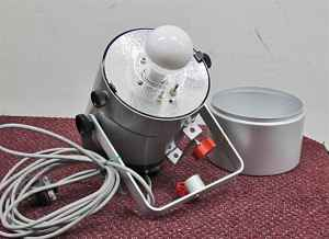

I have an even older (early 1970s?) version of those. As best as I can tell, there are no current light modifying accessories made for them. There may be something out there that is adjustable and could be made to work.
Here is a photo of one like mine:

@AgX: yep, that's what I thought as well... I guess mine of are an older generation
@bdial: maybe... i could find an extra cap or speed ring to DIY one... As stated, distance between mounting screws is about 6.5"

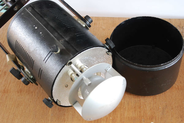

@MattKing: Mine are maybe just a little more recent than yours and might be the same size? Here's an old photo... I'll get around to doing one of the front end later.

Mine has a built in connector for an umbrella that it appears has been removed from yours.

@MattKing If you look carefully at my second photo, there's a hole to insert an umbrella and a locking screw to tighten it down... If I'm reading your photo correctly, you connector is attached exterior to the main "can" of the unit, whereas mine is inside the "can".
MattKing
Apr 24, 2005
52,906
Delta, BC Canada
Correct!
