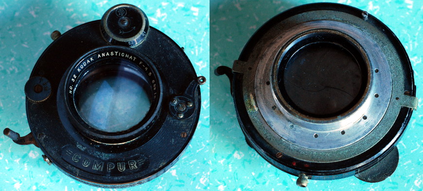

I've got an old Kodak No. 2 Anastigmat 6 3/4 inch f4.5 lens in a Compur shutter I'd like to play with. The lens is also marked EY32-339. The Compur shutter is marked Made in Germany, I can't read the serial number.
I am not sure what size flange it uses or where to find one.
Measuring with a caliper shows the outside of the threads measure about 44mm.
I've seen charts which say a Compur 1 is the same as a Copal 1 at about 41.6mm, the next size up is the Compur 2 at about 52.5mm.
Am I measuring wrong?
Let me know if you have a flange to fit.

http://www.skgrimes.com/products/mounting-flanges/metric-stock-flanges
That is a very old Dial Set Compur. The link shows it to be 43.95mm .9mm thread pitch. Good luck finding one on ebay as those jisters rarely know how to measure lens mounts.
Do not cock the shutter when the mode selector is set to B ot T, only cock the shutter when set to I for instantaneous.
Copal/Compur numbers do not apply to this vintage shutter.

The 1943 Kodak Reference Library lists a No. 32 as a f4.5 6 3/8", not 6 3/4". The shutter is a No. 3 Ilex with the lens board mounting hole 2" or 50.5mm. The 1948 Kodak Reference Library has dropped names such as No. 32, and renamed the better lenses as Ektar. There is none listed in this focal length and speed. The number EY32-339 sounds like possibly a 1949 date. The scarcity of fine photo equipment in those early post-war years may have lead to some lenses outside the normal naming and shutter ranges. Also, lenses were sometimes remounted in whatever shutter one could find. I hope this limited information doesn't add to the confusion.

The old style (there was a url link here which no longer exists) were a different size to the later (there was a url link here which no longer exists) and used a slightly coarser thread for the retaining rings.
You have a Dial set Compur 2 with a No 4 Tube. If you make yourself a wooden lens board you can carefully screw it into a slightly undersized hole. I've done this a few times once with a Dial set Compur but also with brass lenses when I've no flange/retaining ring.

Thanks Ian, I was wondering about making a wooden board with a slightly undersized hole...
