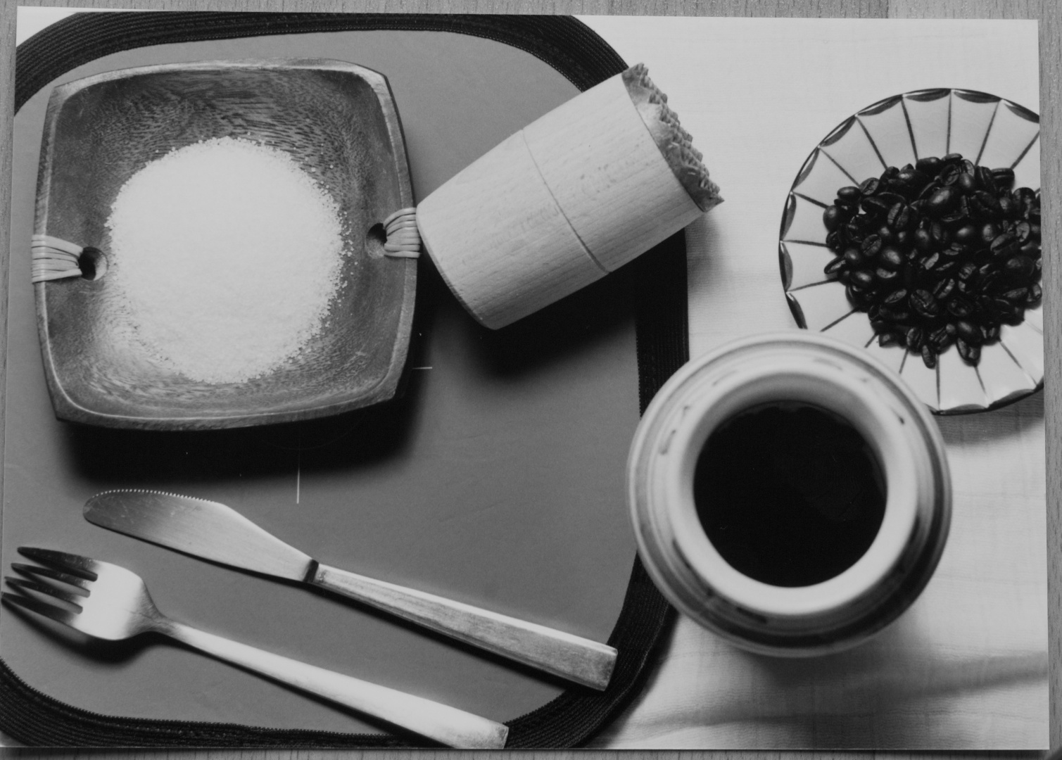

In order to better understand what was going on, I setup a test to calibrate or compare my results.
I decided to standardise on XTOL stock (I've mostly used Rodinal and HC110 before, none gives full film speed) and only try other combos once I got this figured out.
Till now I was shooting tmax a lot, but since people are saying it's hard to print, I'm looking for alternatives and testing delta and panf+ at the moment. I like low grain films when speed doesn't matter.
I've developed against ilford tech sheets and it seems the negatives are slightly too contrast for my enlarger, or maybe not. Fomaspeed paper should have grade 2 with Magenta 10 filter, but my negatives work with just a touch of yellow.
Here are the results:
(I photographed the prints with my digicam and reproduction is not the best)

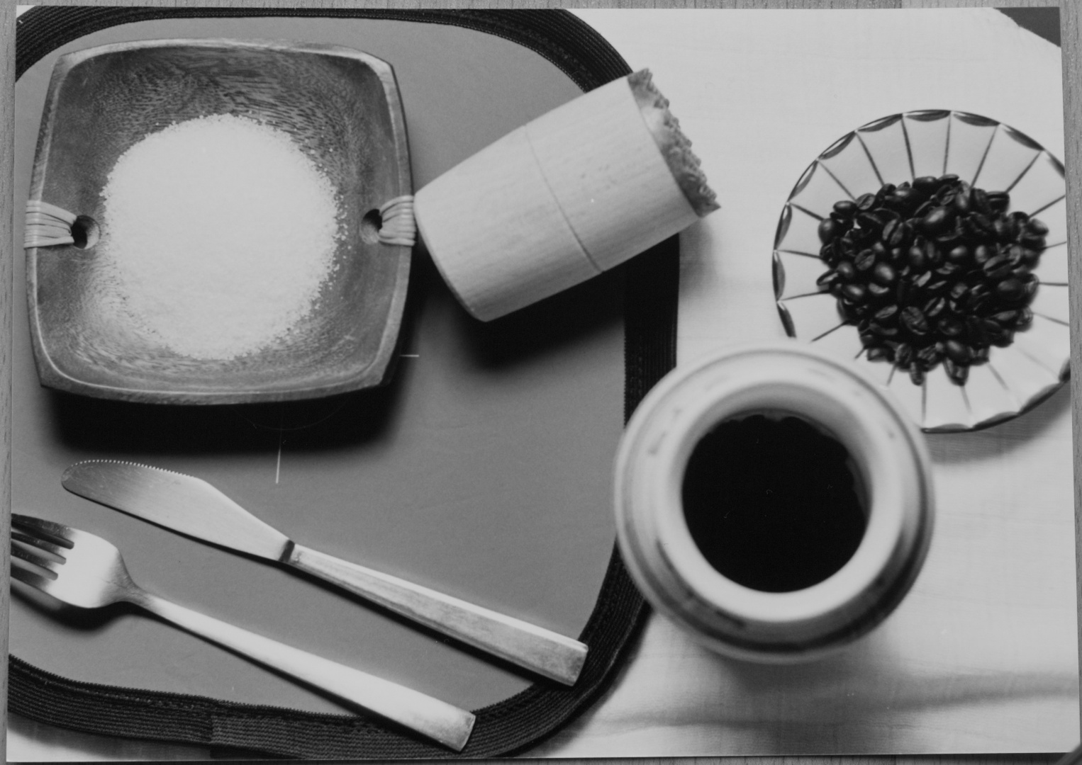

1. Delta 100 at EI 100, Y3:
The shadows are not well separated and maybe a bit dark?
2. Delta 100 EI 50, Y3:
This seems as good as I can make it. Much better separation of shadows!

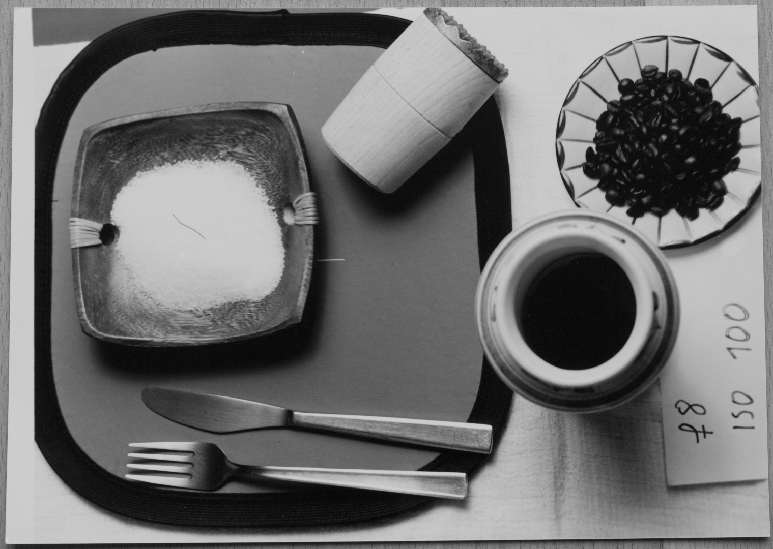

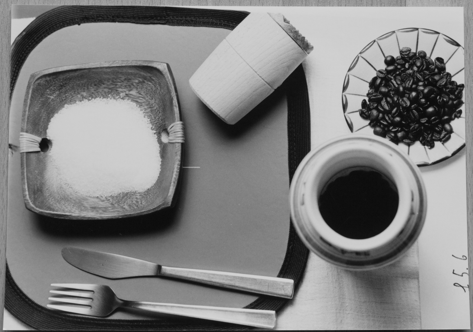

3. PAN F+ EI 50
4. PAN F+ EI 25
I see no real difference in EI50 vs EI25 in FPAN. Also, the result seems very, very close to delta. I'm not sure I could tell them apart if the scene was the same.
It seems ilford's published times give really coherent results, as both film had contrast best printed with the same contrast filter. Both have highlights in the sugar clipped. Haven't tried burning yet to see if there are any details in there.
Questions:
1. What do I change, if anything? I'm thinking of trying reduced development times and try to get results printable with M10 filter.
2. Are the examples above OK or is there anything I could and should do to improve them?

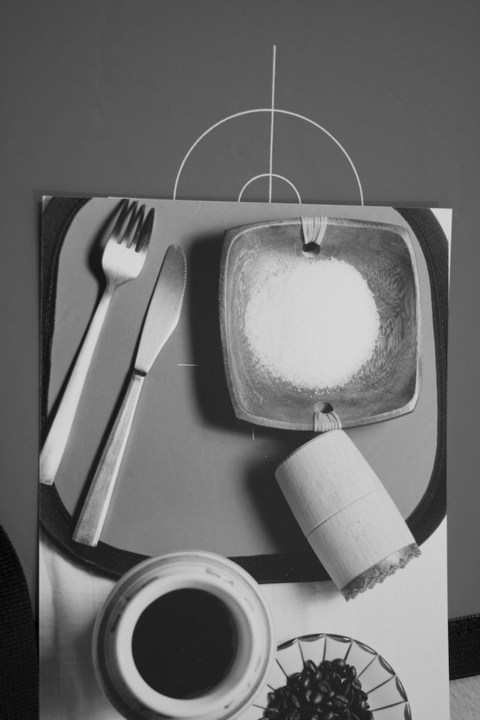

One more question: when properly developed and printed, should the gray card on paper be 18% grey, the same as the real grey card? My guess is not, as we are only reproducing the relationships of tones in the scene on a medium that has a shorter tonal scale.
my printed grey card is about a stop brighter than the real thing:
As I remember the Zone System, yes, the idea is that 18% gray card is 18% gray print. The gray card and the Zone V print are the pivots point around which the system revolves, so to speak. All else being equal, having the card be brighter points to overdevelopment, raising that value into the next zone. Then again, your meter could be set for a different gray value than 18%, leading you to overexpose (meaning that you have raised zone 0 to zone 1, and all the others will go up
But, always the but- there are a variety of issues at play. For example, the color sensitivity of the film and the light will affect how certain shades are reproduced. Filters on the lens will also change the rendering of different colors. Paper development and exposure has its own 'zone system' at work, and you can introduce variations there.
In the end, if the print looks like what you want it to look like, you did right. All of these techniques are tools, not religions. If it gives you the control and understanding you want, keep going.
A reference point like the grey card provides a connection between scene and print, it is just a place to start, a way to waste less paper when printing. I do use reference points (various and sundry reference points, see below) with my enlarger meter to set exposure for the first print (when I use a grey card) and depending on the target to set paper grade (where there are both a black and a white point).
What a single point does well is to "correct" enlarger exposure for changes in camera exposure (purposeful or inadvertent). This is possible because most negative films have some latitude. This may be why you see little difference between prints from differing EI's with PanF and Delta 100.
(Side note. As reference points I use; my palm, my camera bag, my truck provides both black and white points, asphalt, northern sky, grass, in studio setups I use a rag doll ... Any "known" reference point can work.)
That's an really interesting question. I don't remember reading about this relation anywhere.. just.. expose for the highlights, contrast for shadows, when printing.
In my example, to bring grey card down, I'd have to use more contrast (more exposure would darken the highlights), but then I'd have really bad separation in everything under zone V. I'd lose the delicate light and shadows, and the print would look way to harsh.
I have another negative with same exposure but 20% shorter development time. I still need to print it to see if there's any difference.
Essentially you are talking about pure straight printing.
Our subject matter can, but doesn't always, fall exactly where we might prefer it on the print. Heck at the contrast rate we want (where we get the right "snap" in the print) all the subject matter we want might not even be visible.
The grey card is a "stand in" for mid tone subject matter. When I look at a photo, one of the things that stands out for me is whether or not things look "as I would expect". If mid tone stuff (like a grey card or face or building or coyote) falls too light or too dark, in relation to what I expect from a real situation, it looks weird, wrong.
Moving the mid tones around a bit with a bit of burn or dodge can make a huge difference. Getting say the shadow point and the grey card right and then burning in the highlights may work better, or get the highlights and mid tones and burn or dodge the shadows.
Reference points give us a way to figure this out with enlarger meters or test strips.
