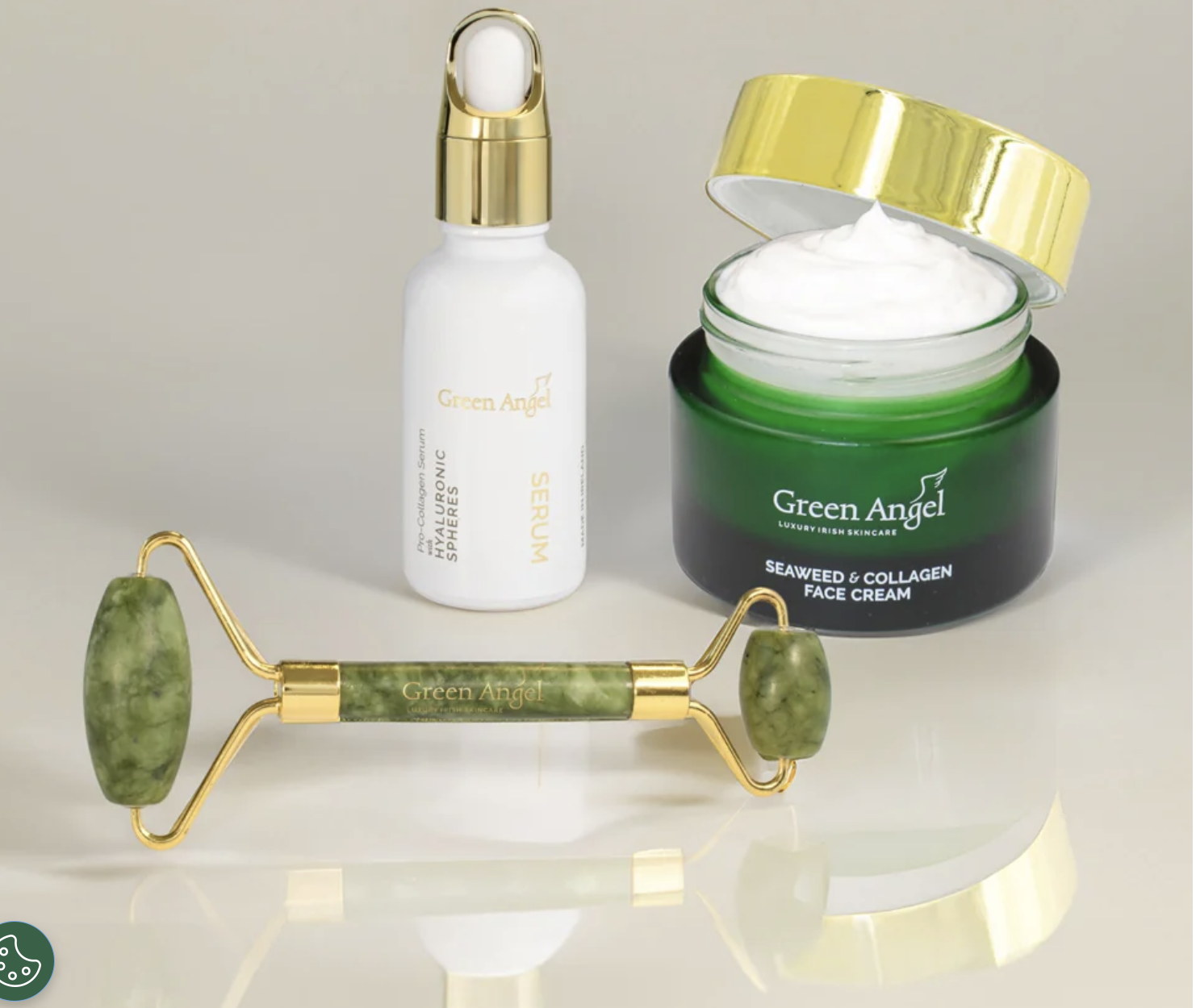

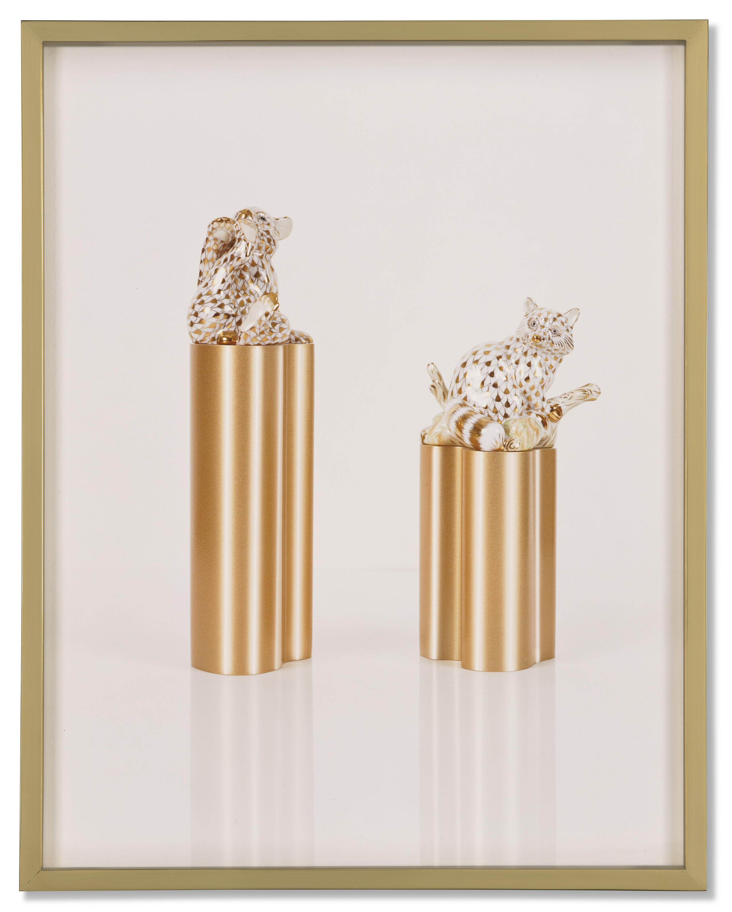

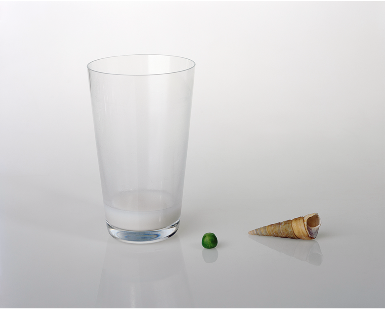

Hi Guys.
I'm looking to recreate a similar look to the images attached below and wondering what set-up and materials I would need to achieve this seamless backdrop and reflective surface combo?
Any help on this would be great!

All three images are taken with the objects on a lightbox, with perhaps grey plexiglass on top. The first image is also back lit (the only way to photograph glass to make it look like glass). the other images are also lit from above with a soft box.
