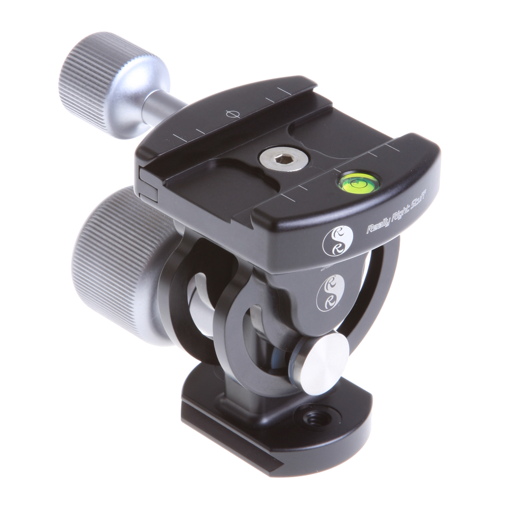

I have the MH-01 pro head (monopod), just like shown here:
or
I just need the plate to go under the camera, or the grip. I do not need any bracket, etc....

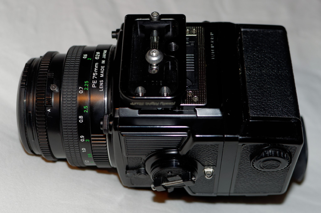

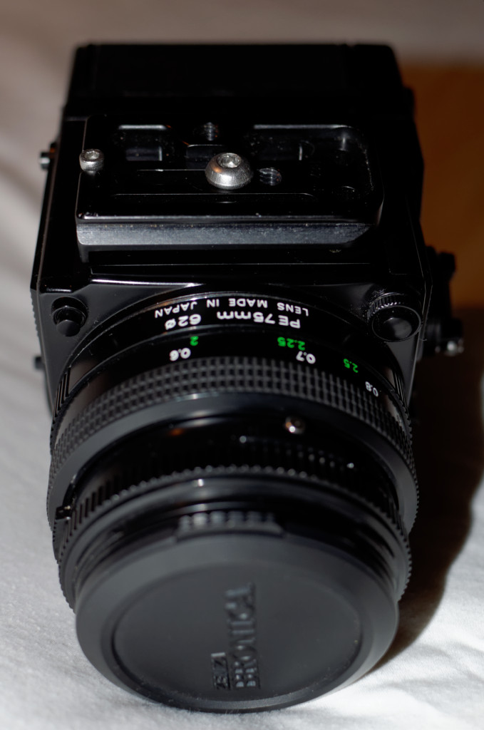

The is the Really Right Stuff B82 plate mounted on a Bronica ETRSi.
Note that while I originally installed the plate running from front to back because I thought that otherwise it would foul the bevel at the edge of the tripod mount, when I was reinstalling it now for the pictures I found that it actually clears the bevel, so it is possible to install it running left to right as shown. However it does still block access to the battery compartment.

If you have the grip on, the edge of the plate would be in conflict with the lock knob. Unless you run it from front to back, which makes it awkward in handling. This is the reason I like the plain plate without the edge. A simple plate is all I need.
