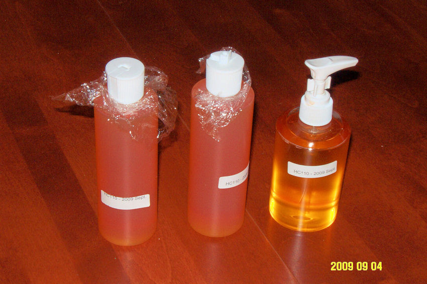

I've been using my HC110 in a different way recently, and it seems to be working.
First, I transfer the HC110 to smaller bottles with caps that permit pouring small quantities, or a pump bottle (see photos below).
Then I take a small Paterson 45ml graduate and put a quantity (usually 24 or 30 ml) of 20 C water into it.
Then I slowly add the HC110 to the graduate, at 6ml per roll, until the volume is up to the proper indication (30 ml, 36 ml, 42 ml or ?).
Then I rinse the graduate several times into my larger graduate, using 20 C water. Finally, I add enough 20 C water to bring the total volume and dilution to my final target (I've standardized on 1 part HC110 syrup plus 49 parts water, or just about dilution E).
I waste a little bit of the syrup by transferring it, but I'm willing to accept that.
