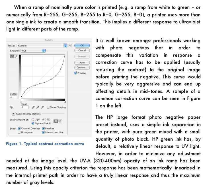

this too is ancient -- inkjet chemists usually have at least one UV resistant ink. HP as far back as last decade talked about it being useful for such processes as Plat.
It's not that they designed an UV opaque ink particularly for this application, as far as I know. It so turned out that their green (their larger printers had a green cartridge) had the highest UV absorbance, better than black that was available at the time. (I had the smaller B9180 printer using the same set of Vivera inks, except the green cartridge, but still gave the best UV opacity in the green patches.) The pro printers had an added advantage that they had built-in spectro-photometers so one could easily find the right correction curve for a given process within the printer itself. HP tried to commercialize this capability for a while - I think out of their Spanish lab. Perhaps too much of a niche for them to pursue seriously.
In any case, none of the other printer makers have gone out of their way to maximize UV opacity to any degree. That's why there is a lucrative off-OEM business marketing UV inks primarily catering to silkscreen-making that requires even greater UV densities than alternative process negatives.
