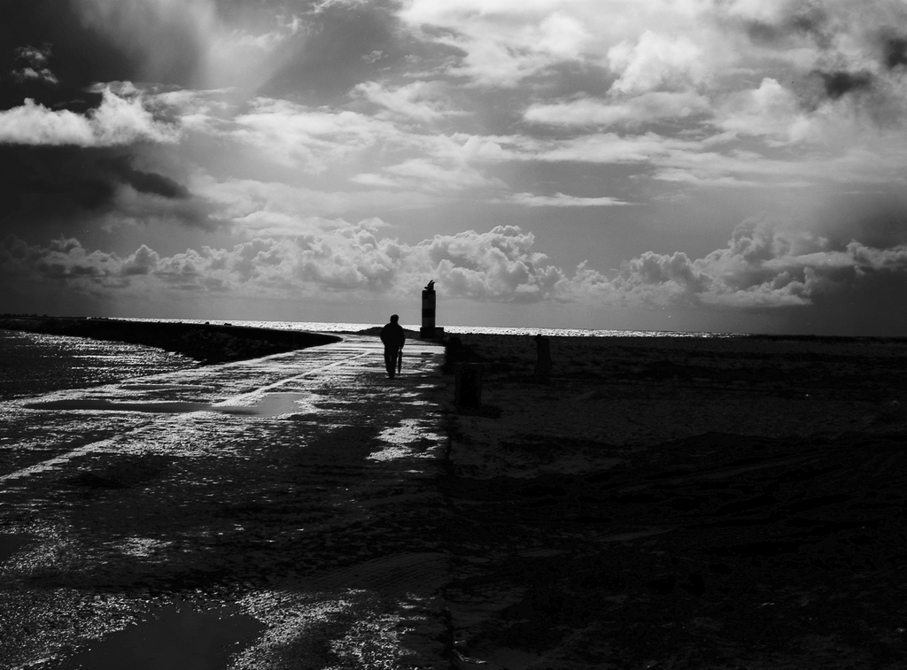

The question I ask maybe one of those that have several answers and/or fall in the matter of personal taste or subjectivity.
I have this photo, taken in a overcast day, with adox cms 20 at iso 20 and develop in rodinal 1:200 or 1:300 (can not remember) 18m. After scan, I decided to play a bit with the contrast and boost it, in Lightroom.
A couple friend of mine saw this and quite like it, saying that would love to have it in the wall. Since I'm in the verge of beginning printing in home, I decided that would be a good Xmas gift a home made print. But I am very green on it, besides knowing some basics.
So I ask what kind/brand of paper to get this same result. The negative is not so hard/contrasted and on my humble knowledge I think that I have to use a grade 4 or 5 paper (or corresponded grade filters on various contrast paper) and possible cold tone paper/developer. Or a neutral tone paper but a cold tone developer or vice-versa, right?
I think it would be an excellent learning experience to use some variable contrast paper and filters to see what you can do with it.
I like Ilford and Foma papers; Ilford has less drydown which is advantageous (drydown causes print gets darker as it dries). I think blacks are a little heavier hitting with fiber paper than RC paper, but for 90% of things, either paper will do. fiber paper will just require more washing and drying time. Get the horizon level when you print it too.
I would recommend any multi-contrast paper and a standard developer. That's the last thing you should worry about, really. Also, be generous with your fixer. It's cheap and it's the last thing to try to save some nickels on.
I'd recommend that you buy a smaller paper and practice making the print, and once you have the procedure, replicate it on a large paper and finally frame it.
Good luck!
I'd lean toward a warm tone paper with a very slight texture - glossy fibre paper air dried.
