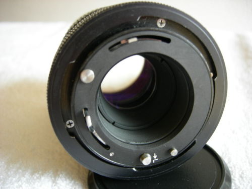

Please help to identify this lens mount.

Looks like Canon FD. It's a pain to test the aperture on these lenses because of the bayonet mount.

Sure does look like a Canon FD mount to me.
Not that hard. Unlock then turn the breech lock ring counter-clockwise then you can push the stop-down lever in same direction. On Canon lenses it stays there (for use stopped down on Macro bellows and stuff). On the picture it might be a third party lens, there's a button marked L that might have the same effect?
