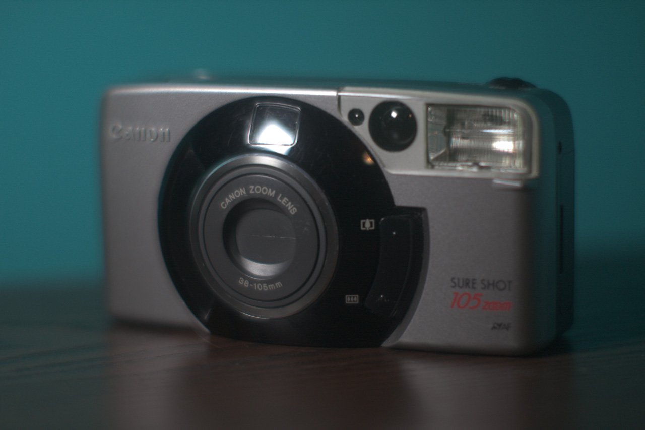

Fuji Acros.
Boring? ImageUploadedByTapatalk1398621582.634510.jpg ImageUploadedByTapatalk1398621582.634510.jpg
