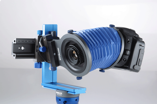

naturephoto1
Mar 26, 2006
1,960
Breinigsville
Hi Dan,
Here is a link to the Novoflex bellows. It is not inexpensive (German). You are interested in the Tilt- / Shift-bellows BALPRO T/S (and possibly the PROshift+ Adapter) (you have to navigate through macro equipment to the bellows to the Pro):
http://www.novoflex.de/english/html/products.htm
Novoflex has adapters for cameras up to 6 x 7 for the bellows.
Rich
