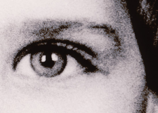

I tend to get more intensely orange prints if 1) the developer is well used, and 2) it's very heavily exposed. The selenium imparts sort of a copper color.
This is a crop from a split toned lith print. You can see the brown color of the selenium toning in the darker areas, and the blue from the gold toning in the lighter areas.

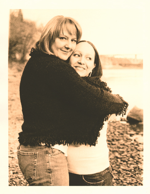

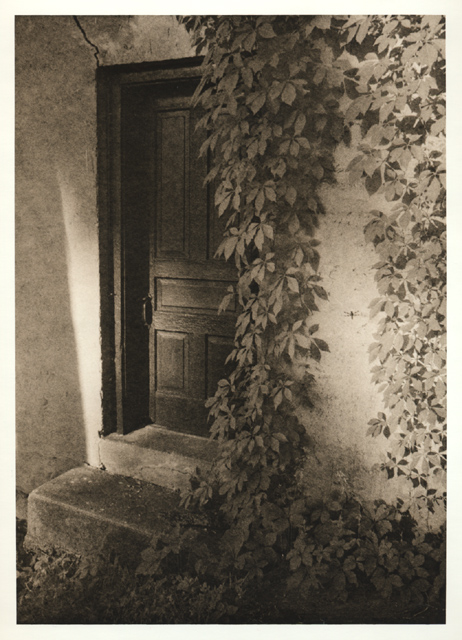

Try printing with Fotospeed LD20 on Fotokemika Varycon. Gives a very nice brown/green tone that isn't the 'cutest' around. You can build some really impressive densities with this too, so check it out. It's also pretty cheap, available from Freestyle. Here's an example. Hardly a rock band, but you get the idea.
The second example is of the Fomatone in the same chemistry. I used 15+15+970 dilution at 70*F.
- Thomas
