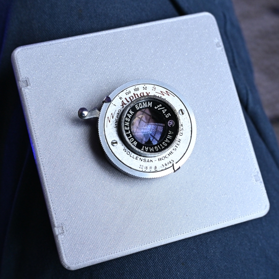

I'd agree that consensus that this is a mid-century half-frame 135 lens is correct. I've got a 50mm Wollensak in a Speed Graphic board for novelty purposes.
Not suited for infinity, at all, for a variety of reasons but heavily vignetted close-ups are possible.

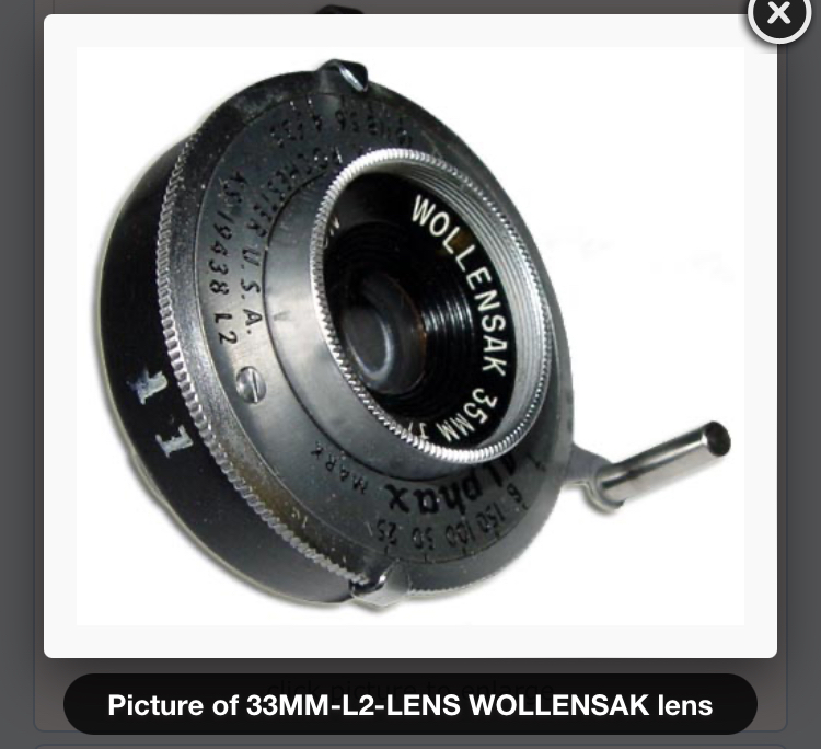

That looks like a wollensak amaton 35mm f/3.5. You can find out more information at alphaxbetax.com by looking at their collection of old catalogs and brochures.
It covers a 35mm frame at infinity but it has no cable release port on its shutter which makes it difficult to use.

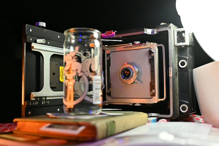

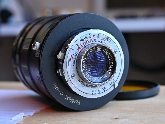

I just remembered I've got another 50mm Wollensak lens in a similar Alphax shutter adapted to the Nikon F mount. Slightly different speed range and this one has a threaded cable release. The slow speeds are sticky on both copies but fine at the higher speeds. Adaptable to any film camera or digital body, if a bit awkward. With the proper amount of extension + a helicoid you can achieve something that resembles a normal focus range.
Here's an impromptu close-up flat field sample at f/3.5 and f/8. Nothing magical, really.
Edit/addendum: I took a snapshot showing the coverage of the previous 50mm f/4.5 lens on a Speed Graphic. Magnification is close to but just under 1:1 in this instance. Working distance is similar to the extension, ~100mm. It covers more of the frame than I thought but the vignette is very pronounced.
