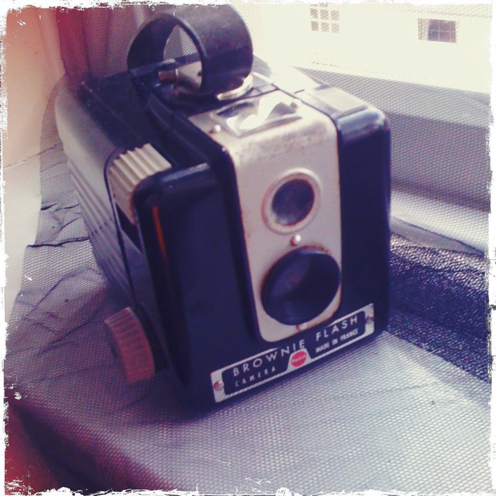

And where can I find some info on it to try and see if it works? I suspect it may not, however I can't even figure out how to open it!

Don't remember the exact name, however, it was the first camera I ever used (family camera) and it took 620 6x6 photos.

When you open, open carefully : old bakelite may be easily broken...
Name is Brownie Flash.
Me too, a long long time ago:sad:

This is a Kodak Brownie Hawkeye, one of the few 620 cameras that will work with 120 film provided you have a 620 spool for a takeup reel. There is enough room to just barely accept a 120 reel. Film with cheap plastic spools work best since they are often narrower. If one brand does fit then try another. Wind slowly and remember to cover the ruby window with a bit of black tape between exposures. Have fun.

It's here a Brownie Flash because it's written "Made in France" on the front (and usually "fabriqué en France" inside).
Brownie Hawkeye has some little differences on front (name...).

Yes.
Like not saying "Brownie Flash" on it?
I wouldn't think it necessary to look for some "made in France" thing to find out that it is a "Brownie Flash" when "Brownie Flash" is what it says on the front.

Yes, I had forgotten the main feature : it's written "Brownie Flash"...
By the way, is there a sync flash on the Brownie Hawkeye ? (I was told not all have one)

The names of these cameras are not so obscure as the
posts suggest. Some were sold without flashes -- they
were Brownie Hawkeyes. Some were sold with flashes
(with holes for the flash in the camera body) and they
were called Brownie Hawkeye Flashes. There is an
active Flickr group devoted to the camera, with over
800 members and over 6,000 photos posted:
http://www.flickr.com/groups/browniehawkeyeflash/pool/

I have this exact camera and use it almost daily for a shot or two. Here's what I know. They were made from about 1949 to 1961. Yours looks to be from the early 50s, judging from the metal film wind knob and the body release is on the right-hand side of the strap. The very first year or two there was no provision for flash attachment (right-hand side.) Mine was made about 1959. Camera takes 120 film, with a catch. I use regular 120 film and put a 620 take-up spool in position. There are a couple of metal tabs you can bend so they don't contact the inside of the camera. Do a google search. I put a little silicone spray lube on the film spools so they turn much easier. You might have to take the viewfinder apart to clean out dust. Easy to figure out. The shutter is about 1/50s, and aperture is about f16 to f22. I've been shooting ISO 400 film in mine, adjusting exposure by using either ND or colored filters. I put a piece of black velcro over the red window because sunlight will leak in there if it's uncovered. I have my (local) lab save the 620 spools for me so I can reuse them. I tried cutting down a 120 spool to use as a take up spool, but that just didn't work for me. In older versions like yours, I think the 120 spools will work as take-up also, especially if you bend the tabs. Camera is plastic, not Bakelite. I've been getting some cool artistic shots from it. Camera's official name is Kodak Brownie Hawkeye Flash. It is possible to change the flash sync from bulb to electronic by adjusting when the internal switch makes contact. I haven't done that though. I try not to place camera in bright sun because I think it might have a small light leak somewhere. If you take the lens out to clean it, look for a little metal stub and remember which way it went. If the lens is glass, it is an older model. If plastic it's a newer one.
