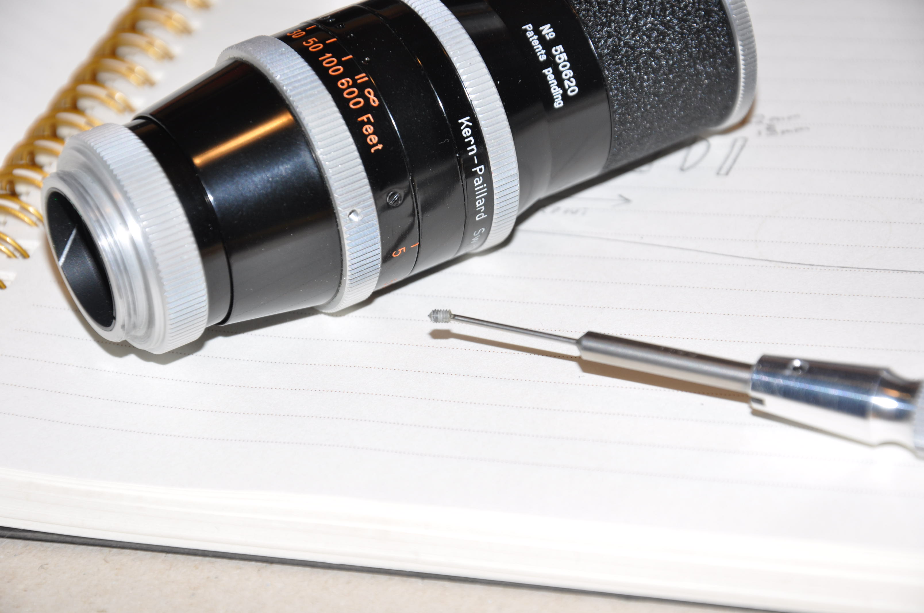

The focus ring on my Zenobia became lose all of a sudden and it feels like the outside ring doesn't move the lens / doesn't focus at all.
Pics and videos here.
But the screw is so small! I would love to know how I can take it apart (as in, which screwdriver I need) and how I can recalibrate to make sure I put it back together properly.
This is a huge bummer because it's one of my main cameras and now I have to fix it before I can use it again :sad:

I see that the front trim ring with the writing is not rotating with the focus ring, and presumably it should.
It is likely that the focus ring is held onto the barrel of the front lens group by those 3 setscrews with pointed tips digging into the lens barrel. Use the right size flathead screwdriver (the Vessel set , or a good driver like Wiha or Wera of the right size. Cheap so-called jewelers' screwdrivers can make it worse).
You can then probably back out the screws enough to gently pull off the focus ring without actually taking the screws all the way out. Look for the divots in the lens barrel, that will tell you where the ring was originally lined up. With the focus ring off, you can turn the lens barrel by hand, if it's very stiff, that's probably why the ring came loose and it should be cleaned and relubed. If it's not stiff, then the screws may have just backed out enough over 60 years to let go.
There may be a 3-way ambiguity about how to position the focus ring screws if they are distributed symmetrically. The lens group may screw in a little further past infinity; if so then screw it it out a little beyond the furthest-in point and figure out where infinity lines up with the focus mark and the screws line up with the divots. If not, you may have to pick a position and then do focus tests with a groundglass or on film.
