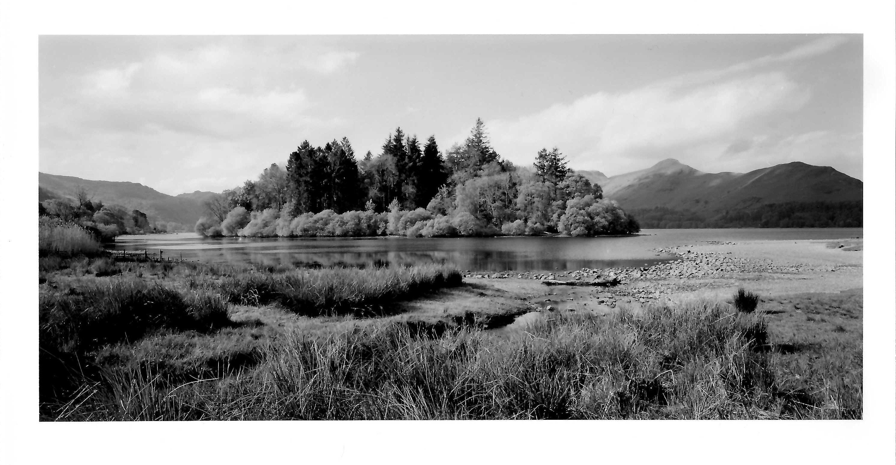

I've shot quite a bit of 6x12. And just like any other format, if you find the right subject / composition, it's perfect. Although, more often than not, especially at the beginning, you may find your compositions stronger by chopping off some of the left and right hand sides or top and bottom depending on orientation.
6x12 roll film holders eat film and certainly when wet printing, you'll find yourself chopping paper as nothing seems to match the 1:2 ratio.
On purchase, make sure the back has a snug fit and that the light baffle is in order with the darkslide out. Try not to damage the delicate darkslide. Check that the wind-on is smooth that the tension is good and the frame counter works. And check that the spacing is correct. Happy hunting!
Sorry, attached is a photocopy scan of an 8x10" wet print.
