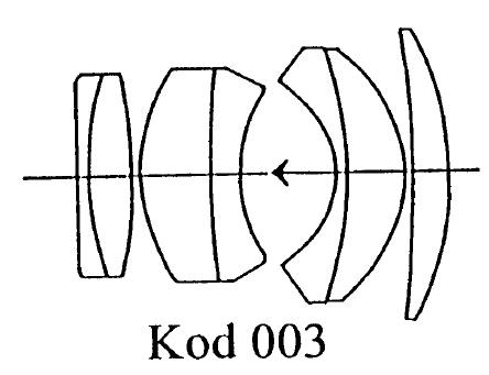

I do not see anything that will affect image quality significantly as is. The haze will reduce contrast slightly. That type of haze usually cleans off.
What is the price? The cells unscrew from the barrel and individual elements can be removed from each cell.
This is the Yellow Dot version from1944. The yellow dot indicates coated by Kodak. They started coating them in 1944.
The lens diagram, arrow indicates direction of light travel and is at the aperture position.
