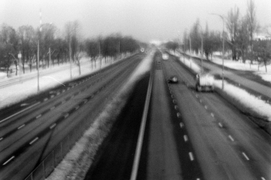

Hi all,
I got myself old summar 50/f2 screw mount for my leica. Glases are clean from scraches and fungus, couple of dust inside, no big deal. But after testing it - I see that something is wrong. Please see attached pictures, they are shoot at f5.6-f8, 1/100s on M3 with adapter, focus on infinity.
It is not development of camera problem because I shoot some frames on same film with elmar 5cm/3.5 and with industar 5cm/3.5 on same adapter and all is ok. Only summar has those not acceptable results. Same is on close focus, wide open, all settings are giving bad results.
thanks,

Yes they are not so good are they? I am going to make a guess at this. Some lenses and I include leitz ones in that when assembled are screwed together in sections. Now these screw threads have multistart points and my guess is the lens has been dismantled at some time and re-assembled with the lens in the wrong position and wound onto the wrong thread and the focussing scale/rangefinder coupling is well out of adjustment.. Only a camera repair specialist would be able to tell fer certain

All is not lost! I had a similar problem with an old 9cm Elmar, and tend to agree with BMbikerider, its probably been reassembled incorrectly at some point. I had my lens fully serviced, cleaned (and coated!!!) and reassembled correctly and its given great results ever since. Its whether or not you want to go to the extra expense to put it right I suppose.

I agree with the others about disassembly and incorrect reassembly. And the lens should be recollimated. I don't know how that's done with the Summar, but I would:
1) Make sure that all elements are seated correctly and firmly, and
2) Recalibrate the lens for infinity focus.

First, find out if the lens, itself, is bad or the mount is simply out of alignment. Do this, Darkosaric:
Hold the lens, wide open, in front of the mount of an SLR that you have, adjusting it back and forth and close enough to the mount, in order to see if there really is a very well focused image that appears in your viewfinder. If there is, there is a problem with the distance that the lens is to the film plane. I wonder if the cam that guides the focus mechanism on the camera is off. Or, I wonder if one of the elements is either reversed or not put on properly. But, again, first you have to determine that the lens, as it is, is really capable of sharp images but only off in its focus.

Hi - looks like it is focussed well before infinity. Is your Leica one with an opening back panel? If so you can put a ground glass against the film rails, set the camera on 'B' with the shutter open and experiment with focussing on different objects at differing distances to see:
1) Whether you can focus on anything at all,
2) What point on the scale currently relates to infinity.
If you can't focus on anything at all, it may be that someone has had the lens apart and lost a spacer or put one of the elements in back-to-front.
If you can focus on something then previous posters suggestions about unscrewing the focus mount and moving on to another thread may be the answer.
If you can't mount a glass screen on the camera, try cutting a card tube to 28.8mm (focal distance of the Leica screw thread body), placing the lens in the front and a ground glass on the back and doing the same experiment. This is a rough and ready way of checking the lens out :>)

I agree with kiev88user. You cannot focus that lens through an SLR.
We can see the lens will project an image from the posted scans. The best method is what kiev suggests, ground glass at the film plane & observe focus.
The Summar and Elmar do not have a focusing helical. it's a continuous thread.
It may be that the focus is off by being screwed in too far or not far enough. The infinity stop is a simple post screwed in place. Remove it and you can check on the GG as the lens is moved beyond it's normal limits.
If it unscrews, no problem, just screw it back in again. If it won't get a sharp image within it's range it's time to consider mis-assembly.
