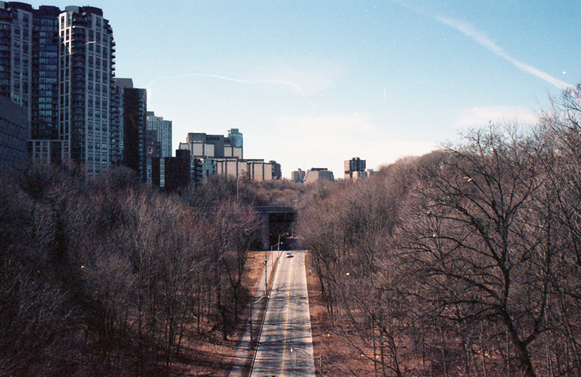

It's a newbie question so many of you will laugh. I have to ask it anyway. :smile:
I bought a Nikon F3HP body and eager to try it out I purchased a cheap Nikon series E 28mm F2.8 lens at Henry's for peanuts.
I shot and developed only couple of rolls (and never touched it again) and almost all frames had marks on them. I didn't develop the film myself. So, my questions are:
1) How do I determine what are the origin of these marks?
2) Why do they seem to show on some frames and not on all?
3) I know it's handheld, but is my manual focusing super lousy or what are the other reasons for poor sharpness?
Sorry for the crappy shots but they're good examples of what I'm talking about.
Thank you!

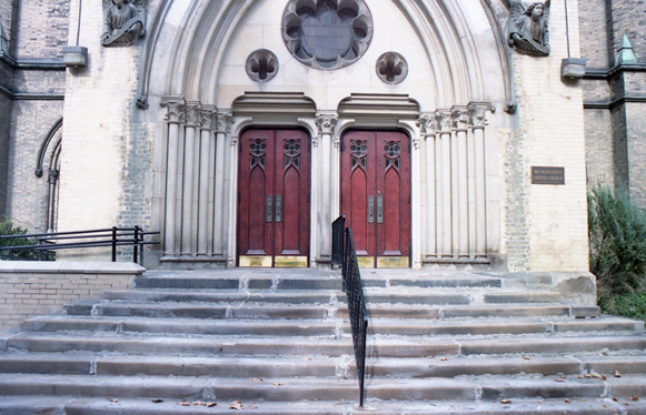

If one has no idea at all where a mark could be originating from, one should use another camera sample, better a different model, best no camera at all in order to differenciate between processing and camera or exposure related causes.
That white circle in the 2nd photo seems to be a waterstain to me.
Chan Tran
May 10, 2006
6,827
Sachse, TX
you mean the dust specks that look white on the print? I have that a lot. Can't find a place that develop my film without making it dirty.
ic-racer
Feb 25, 2007
16,552
USA
The white specs are the concern? If these are contact prints, the dust could be in many places. If they are enlargements with a glassless carrier, the dust is on the negative. If you wiped them or dusted them off before enlarging them, then the dust may have been permanently imbedded in the emulsion during drying or processing.

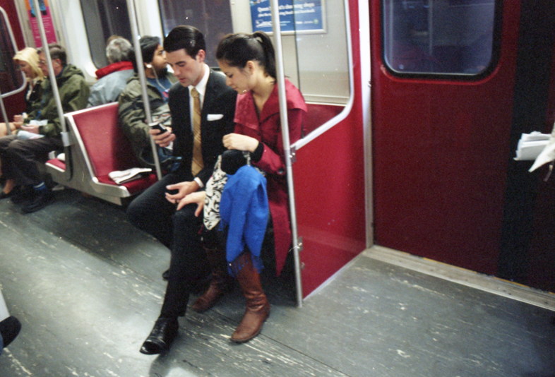

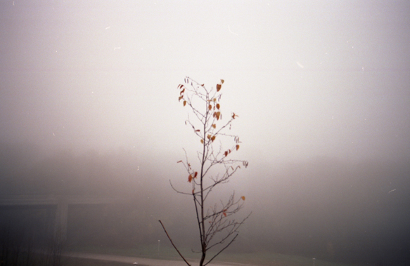

Attached files are resized low quality scans that I received from the developing place and I don't even know where are the negatives now so I can't inspect them :sad: In any case, I'm attaching yet another file where you can see a white mark on woman's chin as well as a similar mark in man's hair and above his head, among others. Is that dust or possibly scratched negatives or...?

It is really hard to tell, my eyes are certainly not what they used to be, but that looks a lot like dust. If those are scans from a local lab then they are not very careful to keep the work area clean. If they always happen in the same location for each and every frame then they could be camera or lens related. If not, then I would suspect the processing end. Maybe shoot another roll of film and send to a different lab to see how their scans look. Also, keep your negatives and go buy a loupe, 8x or 10x. When you see the spot in the scan, use the loupe to check the negative to see if it is on the negative.
As for image quality, contrast, etc., try shooting at different aperture and shutter settings. It likely is exposure related, but could also be developer related. If the lab's developer is becoming exhausted then your prints will reflect that by a washed out look to them.
Lots of things to check, just a few suggestions you might try.

Lens faults generally won't cause sharply defined defects on the film. When the camera body causes problems it's most often long scratches from some sort of damage around the film gate or on the pressure plate. The other common problem area would be light leaks either because of deteriorated seals on the back, or faults with the shutter.
The specs and spots on your shots are not typical for either camera body or lens problems. But as stated, they are usually indications of poor dust control during processing.

If these are scans from the lab, definitely go to a different lab. Those seem like dust during scan (dust in-camera would be black typically), or scratches. Either way, they indicate poor treatment, post-developing.

Marks, dust, whatever, on the focus screen will not appear on the film.
+ as for dust, white spots (in a positive) are from dust that is introduced after exposure, generally either during processing or afterward.
Black spots in a positive are caused by dust on the film during exposure, these sort of dust spots aren't common for 35mm.
