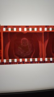

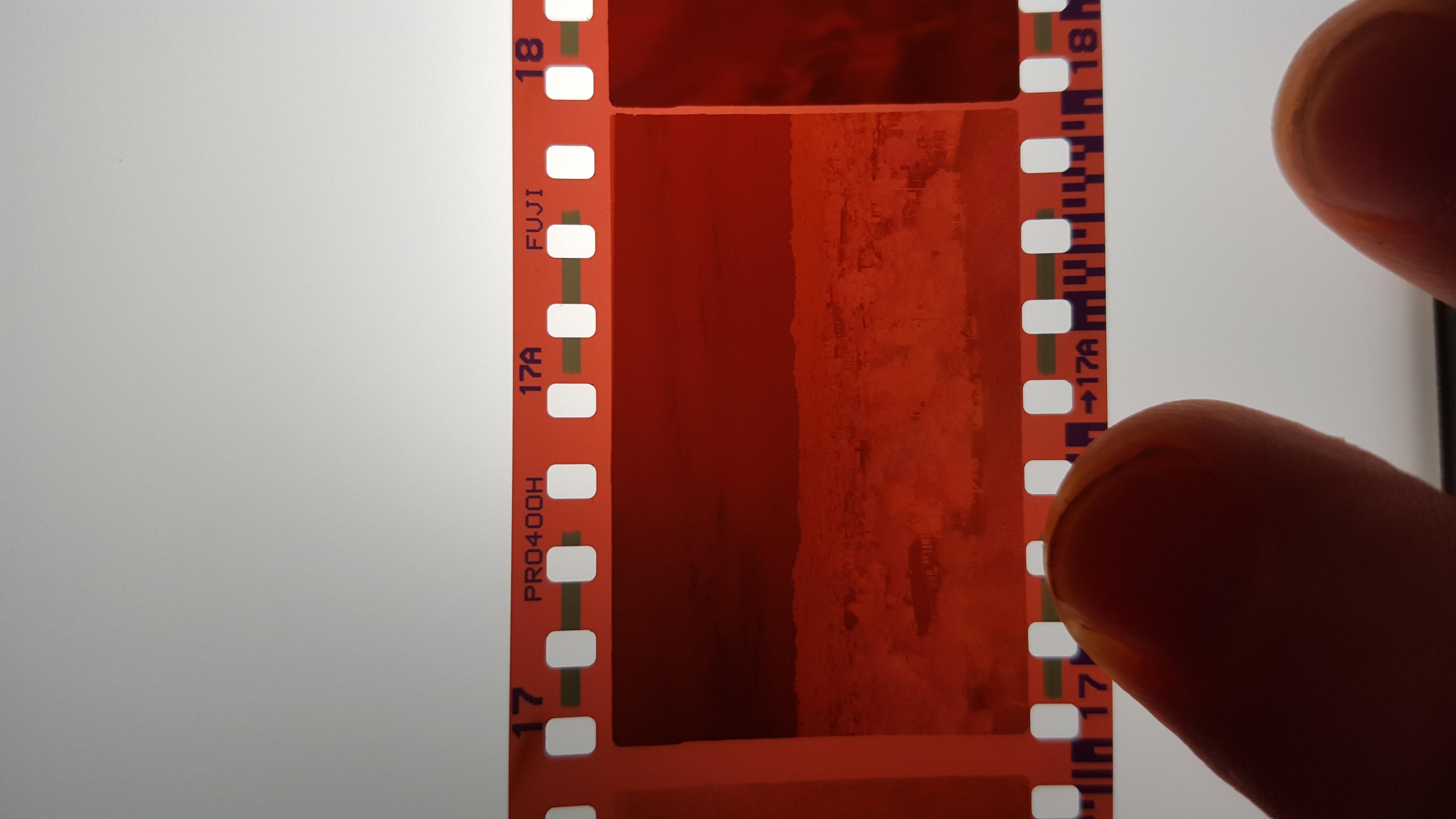

Here are a few cell phone photos of the negatives ontop of a light box. Please look at the top right of each frame something is off. What do i tell the repair man?
attachment.php
attachment.php
attachment.php
attachment.php
Include the negative strips with camera.
The first blind may be stalling.
Remove back select B and depress the release the first blind should complete. Don't forget your negtive image is upside down and left to right.
Don't touch the slats of the blind they are rugged but don't touch...

The image area leaks into the sprockets on the bottom side, and leaves an unexposed strip at the top.
From the other comments in the thread, I'm guessing that this might not be unusual with this model.
The solution may be to learn to crop everything, and avoid mounted slides.

For a SWAG, I wonder if there's a mask at the film aperture slightly out of position

It's tough for me to see if the blinds are not moving at the same rate or uniformly. Looks like they are but the repair man will take a look tomorrow.

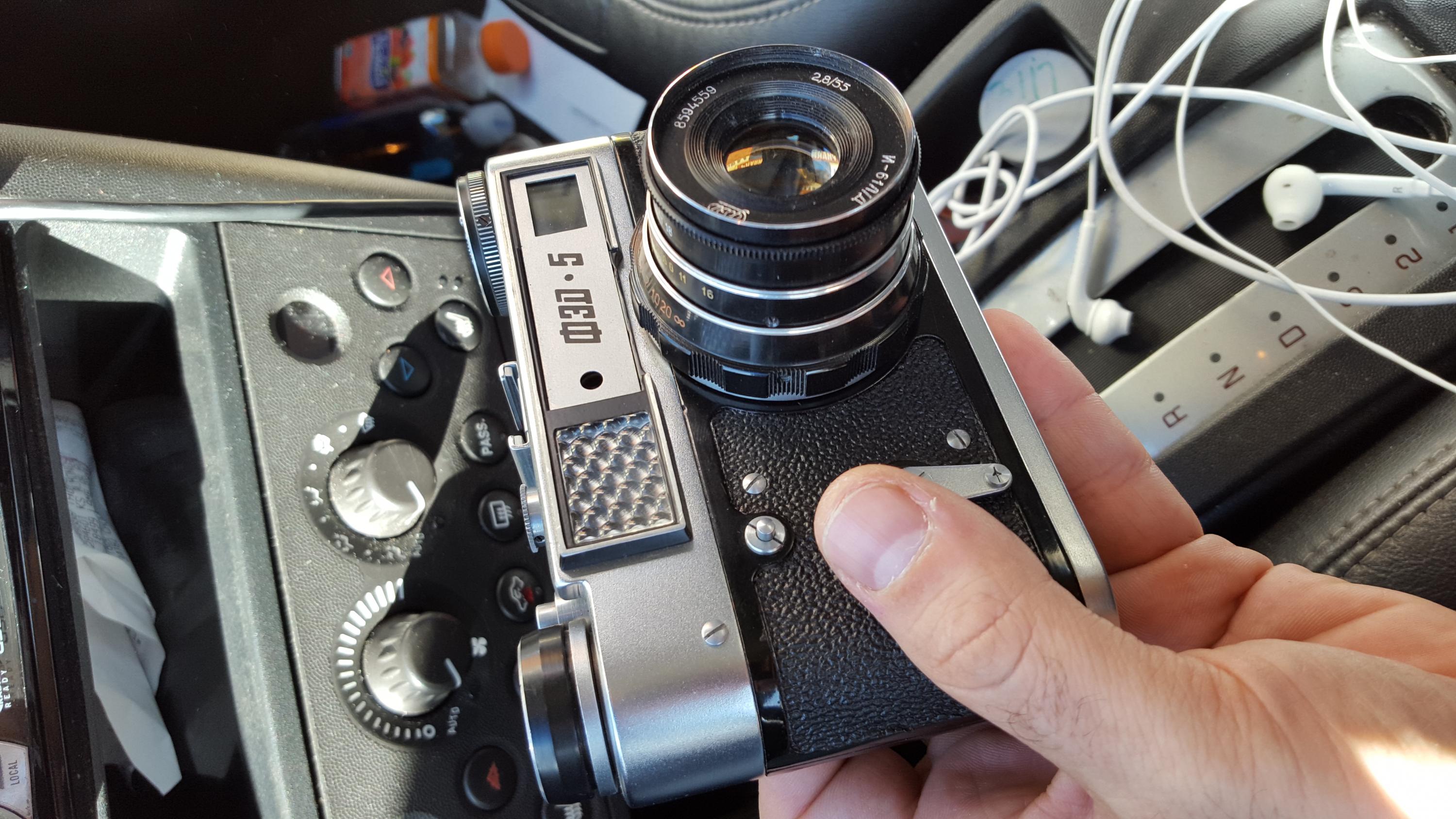

So my repair man took at look at it and the issue inst repairable without spare parts. So we agreed to a trade since he is a collector and i want a soviet rangefinder.
attachment.php
He even gave me some free film to test the camera, and agreed to repair any defects should any be present!
Is this a fair trade you ask? Well i couldn't really get used to the "contax grip" So i'm liking the fed 5 a lot more.
Thanks for everyone's help.
