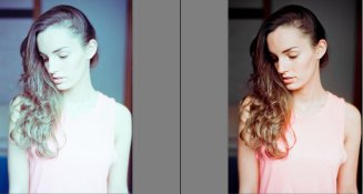

I develop C41 film for quite a while now, but nothing seriously yet. Mostly shooting b/w though. I'm using a CPE2 to develop my C41 negs and I have this problem that occurs once in a while, espcially on Kodak Portra.

On most 1 films I shoot like Ektar, Agfa Vista etc I don't have the problem that much but on Portra I sometimes have a very green or magenta negative, not really color shifts but just a layer on top of the picture that makes the colors very weird.
When I put the white balance back to a good position it's better but I still have some weird magenta hues on skin tones or darker spots in the back.
An example

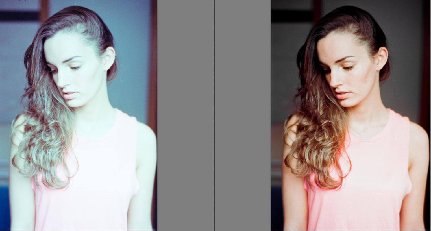

I added an example of what a raw scan looks like when things gone bad, normally the raw scan justs look fine and a little flat, a bit of contrast does the job and nothing to be done... but this time it happened again.
On the right side I made my color corrections, as you can see, there's still a bit of greenish/blueish hue where the hair starts. Which I can't get rid off... but it's just bad anyways. I must also say that the roll has been overexposed too much by accident. So maybe that got to do something with it too?
