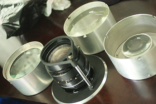

Hi everyone. I'm cleaning out some space in my storage room and I have a some darkroom stuff that I'm not really sure what it is. I bought an 8x10 camera from someone on CL a few months back and a whole bunch of stuff came with it.
I know that the black piece in the middle front is an 8x10 enlarger lens (really cool but I'm not likely to ever use it) but I have no clue what the other 3 pieces are. They weren't together; everything was just in random boxes here and there. I still have a lot of stuff to go through.
Does anyone know what the three light colored pieces are?

They look like light condensers for an Omega Enlarger.

Those are condensors for possibly an Omega D series enlarger.

The aluminum cylinders contain condemsors for an Omega D2, Not D2 V, The are for 4x5, 35mm and 6x9,
There is a complete set there.
